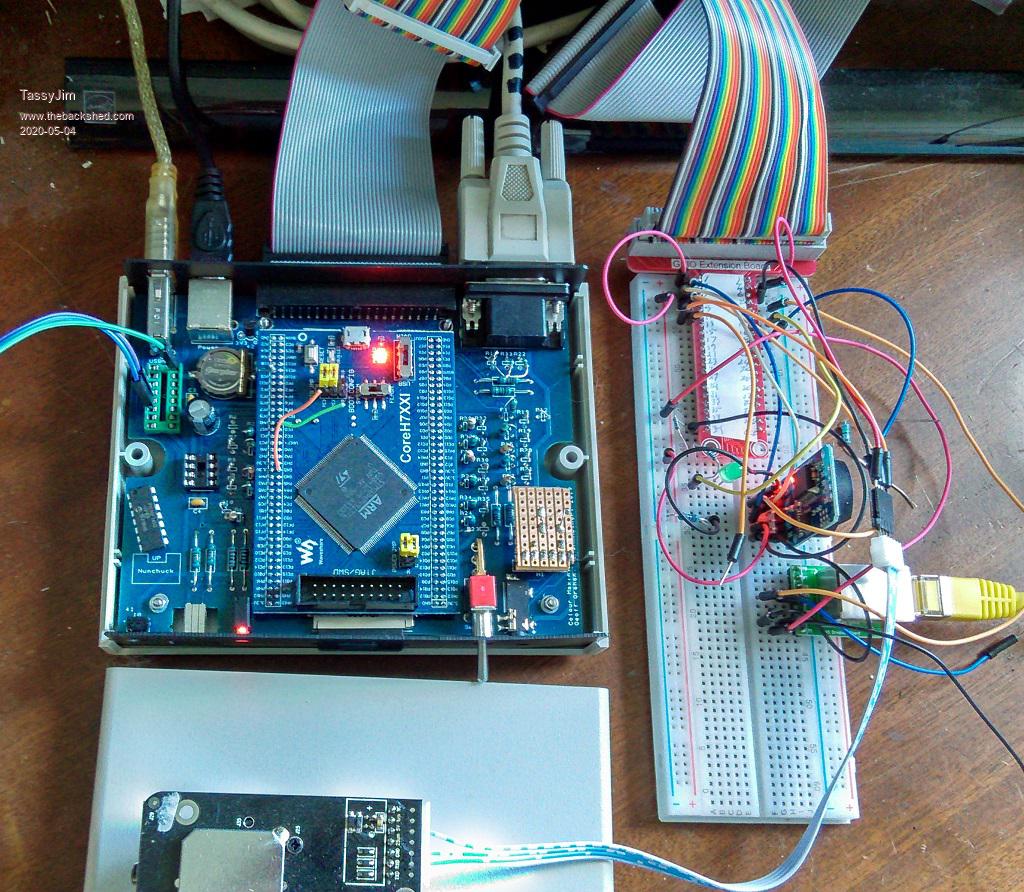

Posts: 6638
Posted: 11:07pm 03 May 2020
I haven't tried remote firmware updates but it might be possible.
Using STM32CubeProgrammer, you have two options applicable to the CMM2 - USB or UART.
USB is the fastest and requires a Male-Male USB cable connected to the keyboard port on the CMM2.
The other way uses the serial port and is much slower. It is that serial method that 'could' be extended over a serial bridge of some variety.
The CMM2 can be put into firmware loading mode with a command-line command so that is no problem.
Resetting the CMM2 after the upload might be needed.
Most configuration settings are retained during firmware updates.
Firmware updates shouldn't happen too often so physically moving the CMM2 to a suitable PC is not a big ask. You don't need a monitor or keyboard attached to do the updates.

Posts: 6638
Posted: 02:01am 04 May 2020
  flasherror said
Questions
1. The only way to power this is via 5V USB "B" connector - there is no separate power jack apart from USB?
2. Kind of concerned about static/ESD on Pin 40 triggering unwanted program erasure. Any hardware filtering or long debounce on this pin for the power-up erase input check?
3. Was there a reason for full size SD cards rather than microSD?
Constructive criticism
Answers
1. Correct, the USB power is it.
2. No issues so far with long 40 way cable and various breadboards connected.
3. Large is easier to solder and easier for aging fingers to handle. Adapters are sufficient for micro cards.
Constructive criticism - you gave the answer. That is not the chosen market.
Serial, I2C and SPI are all available on the 40 way connector.
There are plenty of options for controller boards that need more IO.
Geoff beat me.
Edited 2020-05-04 12:04 by TassyJim
