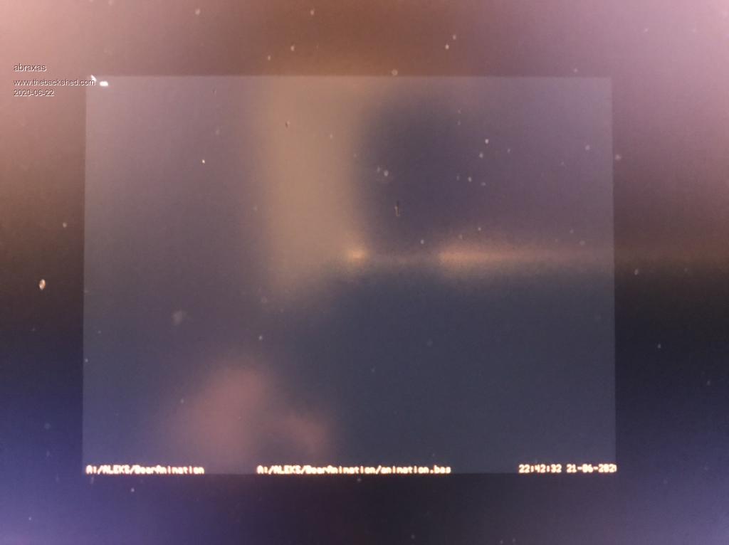

I’m having a mixed bit of luck with the CMM2 and a VGA-HDMI converter. While text is very sharp and clear everything on the screen is shifted exactly 7 pixels so that I have a small border from the right hand side and the corresponding 7 pixels cut off from the 100th character. Seems to occur in 800x600 resolution as well as 640x400 but not with 320x200
Does Maximite 2 offer any way to adjust the VGA timings? My adapter does not have any way to tweak its output and neither does my HDMI monitor beside aspect ratio toggle. The problem exists regardless of the aspect ratio I choose.
Here is the adapter I purchased: https://www.amazon.ca/QGeeM-Converter-adaptador-Computer-Projector/dp/B083K83NNX
And here is a screenshot of the problem

Could be the adaptor, but the CMM2 is so new that very few people have used different adaptors with it. Obviously there's only one sure way to know, and that's to try a different monitor, not easy if you only have one. Some LCDs, especially the older units, have  horizontal and vertical position adjustments, my old unit also has clock and phase adjustments. Sorry can't be of more help, hopefully someone will know a bit more about that adaptor.

@abraxas  I'm not sure if it helps, but I'm using a Samsung 16:9 LCD Monitor with the analog VGA input.
I had a similar (same?) issue that you are describing, with the last digit of the year chopped off.
Fortunately my monitor had a horizontal position adjustment, which required me to move the picture (I believe) 8 pixels to the left, in order to get all the CMM2 screen displayed.
Of course, the LCD monitor's VGA input will be effectively replicating the function of your external VGA -> HDMI (Analog -> Digital video) adapter.
My first reaction was to wonder if the front porch timing was perhaps not adhering to a VESA 800x600/60Hz spec?  But, if this was the case, you'd assume this image alignment would be a more widespread problem?

  GregZone said  @abraxas  I'm not sure if it helps, but I'm using a Samsung 16:9 LCD Monitor with the analog VGA input.
Well I wonder if it just might be... I noticed today that Geoff in his CMM2 user manual a screenshot also has the last character chopped off... take a close look at the screenshot on page 17

  abraxas said  Well I wonder if it just might be... I noticed today that Geoff in his CMM2 user manual a screenshot also has the last character chopped off... take a close look at the screenshot on page 17
Nice observation. Checking the User Manual, I can see that both full screen screenshots show the same missing last character (Pages 16 & 17), conmsistent with what we are both experiencing.
I wonder if it is a more widespread issue, but not everyone notices?

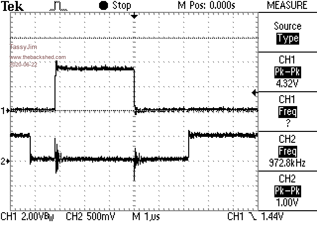

Posts: 6623
Posted: 07:19am 22 Jun 2020
The timing for 800x600 looks correct to me.
This is with displaying a white box
BOX 0,0,mm.hres,mm,vres,1,rgb(white),rgb(white)
Other modes look correct either filling the viewable window fully or slightly under.
Both front and back porch are correct or slightly longer for some modes. At no stage are they shorter than the specs.
Overall line frequency looks good. It's as close as my 20 year old CRO can determine.
This should mean that all modes should fit your display with maybe a slight visible shrinking with some modes.
My timing measurements do suggest that the full display should be visible in all modes.
I don't have a HDMI monitor in 4:3 format to test and all screens I have do have some adjustment available.
