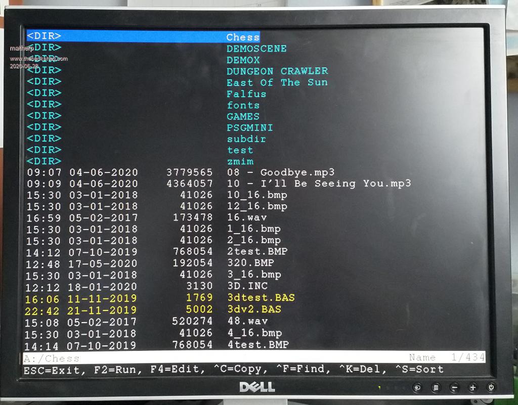

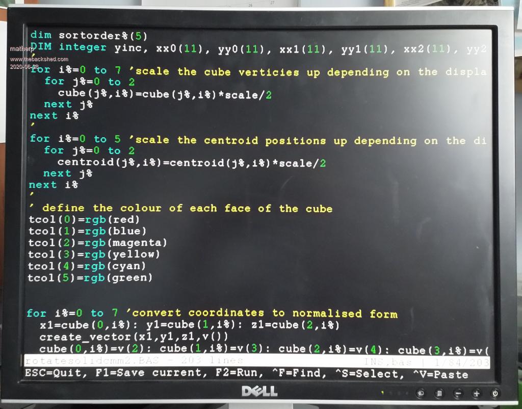

New permanent OPTION: OPTION EDIT FONT LARGE or OPTION EDIT FONT NORMAL
When LARGE is selected this changes the font used in the editor and file manager to FONT 2.
This reduces the editor to 30 lines of 66 characters but makes it much more readable on small screens or with "older" eyes.
The serial terminal is resized to fit. The screen returns to the normal font when exiting the editor or filemanager
Of course the CMM2 supports sideways scrolling of the screen in the editor so using the larger font does not restrict program line length. The new option works as expected with OPTION COLOURCODE OFF and OPTION COLOURCODE REVERSE

OPTION EDIT FONT expanded, new values are now SMALL(133x60), NORMAL(100x50, default), MEDIUM(80x37), LARGE(66,30)

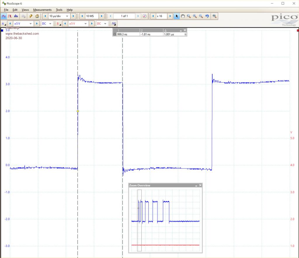

New subcommand:
BITBANG BITSTREAM pinno, n_transitions, array()
This command is used to generate an extremely accurate bit sequence on the pin specified. The pin must have previously been set up as an output and set to the required starting level.
The array contains the length of each level in the bitstream in microseconds. The maximum period allowed is 65.5 mSec
The first transition will occur immediately on executing the command.
The last period in the array is ignored other than defining the time before control returns to the program or command line.
The pin is left in the starting state if the number of transitions is even and the opposite state if the number of transitions is odd
For example:
dim a%(9)=(1,2,3,4,5,6,7,8,9,10)
setpin 3,dout
bitbang bitstream 3,10,a%()
Edited 2020-06-30 03:27 by matherp

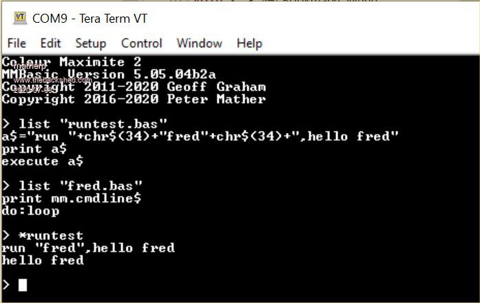

New command:
EXECUTE command$
This executes the Basic command "command$". This is experimental and may not make the final release and comes with a serious health warning.
You will probably find many ways of locking up the system using this requiring a power cycle.
The command is not recommended in high performance programming as it has to tokenize the command before executing it.
Things that are tested and work OK include RUN, GOSUB, Subroutine calls, other simple statements (like Print and simple assignments)
Statements separated by : are not allowed and will error
The GOTO statement will not work properly
The command sets a "screw up timer" before executing the requested command and if control does not return to the command, like in a goto statement, the timer will expire.
In this case you will get the message "Command timeout".
RUN is a special case and will cancel the timer. This allows full programmatic selection of another program to run including passing a command line.

  matherp said  New command:
EXECUTE command$
Nice, I think. Kind of like an EVAL for arbitary statements?
Does this replace the previous change allowing the cmdline of RUN to be specified using a string expression, which doesn't seem to have worked out that well.
