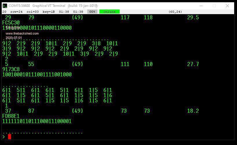

revised version. moved getcode into main body, handle pulse lengths as pairs (short,long or long,short) so no need to calculate a threshold value, other bits tidied up, outputs the code as a 6-digit hex value. is now more tolerant of CPU speed and seems to work ok with CPU 40.
i also see we have a PULSIN function in micromite basic, which could possibly simplify things even further. will experiment with this next.
rob   :-)
CPU 48
Option break 0
SetPin 22, DIN
Dim times(150)
Dim keylist%(20)
' main program begins here
For I=149 To 150: times(I)=9999: Next I
For I=1 To 20: keylist%(I)=&hDEADC0DE: Next I
keylist%(15)=&h0B1864
keylist%(16)=&h0B1868
keylist%(17)=&h0B186C
keylist%(18)=&h089964
keylist%(19)=&h089968
keylist%(20)=&h08996C

Posts: 10052
Posted: 03:18am 01 Jul 2020
Have to go to a job now, but I just HAD to try out your 1st code - and then I see you have already added another one!
Anyway, here is the result of my pressing a button using your 1st code:
I pressed the same button twice, and I note I get exactly the same code back, so that is confirming that the 1st code you posted IS giving consistent results.
I have to go to work now, but I will be back to try your latest code later!!!!

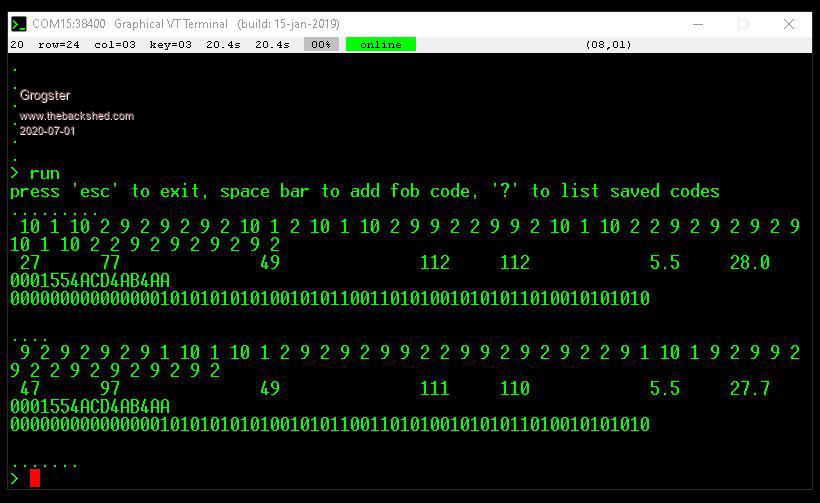

Posts: 10052
Posted: 04:01am 01 Jul 2020
Wonderful!
Here is a screenshot from your 2nd code:
This one is MUCH faster then the 1st code.
I tried three different buttons on this one.
Came here to post photo, and you have ANOTHER one for me to try!
I have yet another job to go to now, but I will be back later tonight to post the results of your latest(3rd) code.

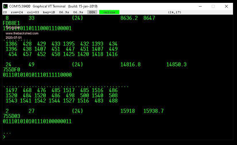

Posts: 10052
Posted: 07:14am 01 Jul 2020
OK, here is the image of Rob's 3rd code:
The first button is a 1527 encoder, the 2nd and 3rd buttons are 2264 encoders with solder-blob addressing.(same address, different D0-D3 bit blob settings)
This is really excellent.  Can you explain what the columns of debug information are, and the line that is 2,27,(24),15918,15938.7 in my image are?
The HEX code for the button follow that, and then the last line is the binary code for the same button, so I follow that no problems, but would like to understand what the other debug information represents.
Posts: 6620
Posted: 07:52am 01 Jul 2020
The first 24 numbers are the times of each bit decoded.
Above 1000 indicates a 0 and below 1000 indicates a 1
On the next row are the starting and ending array slots for the two long pulses indication start and end.
the (24) is the count of bits decoded between the start and stop which should equal the number of readings in the above array.
It does.
the last two numbers are the length of the start and stop long pulses in microseconds.
I think I have it right.
Posts: 10052
Posted: 10:24am 01 Jul 2020
Excellent, thank you for that.  It helps me understand what is going on.

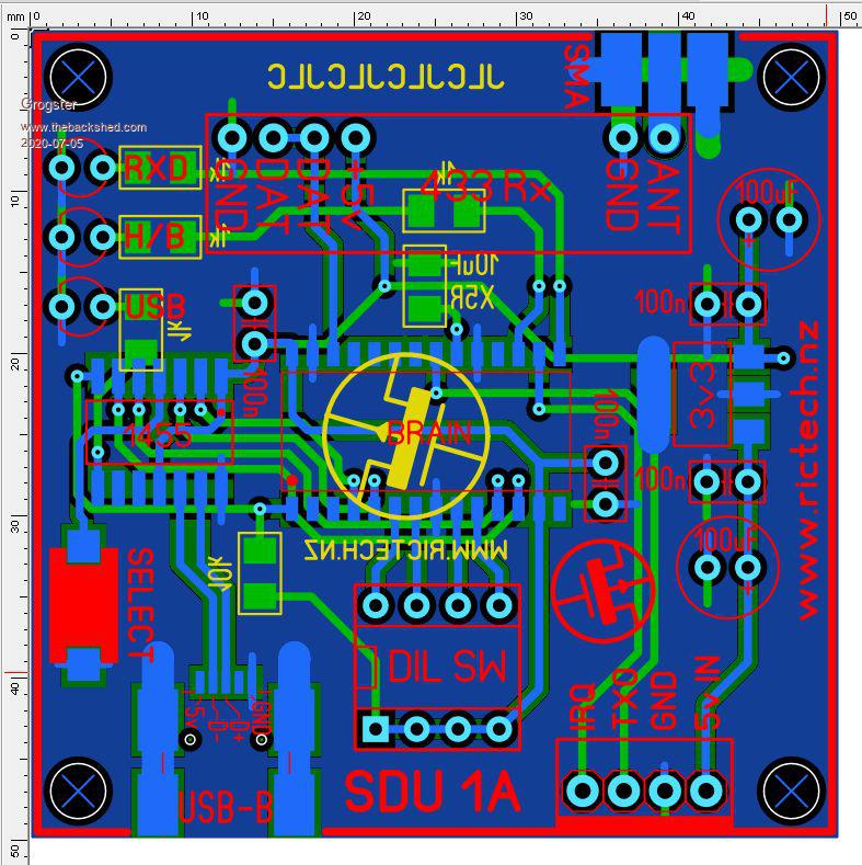

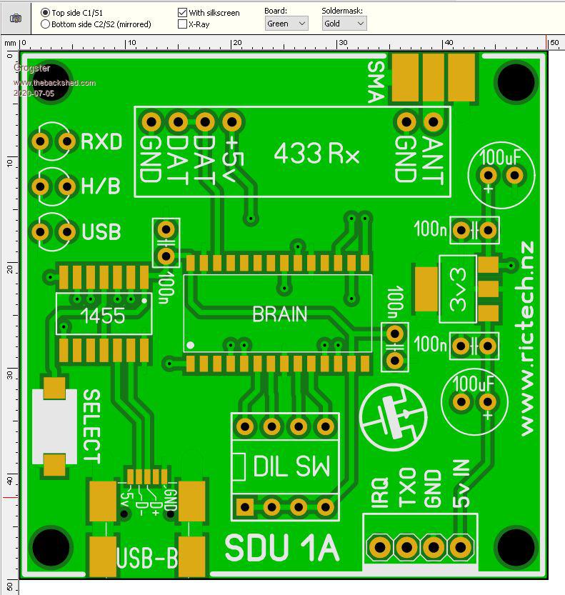

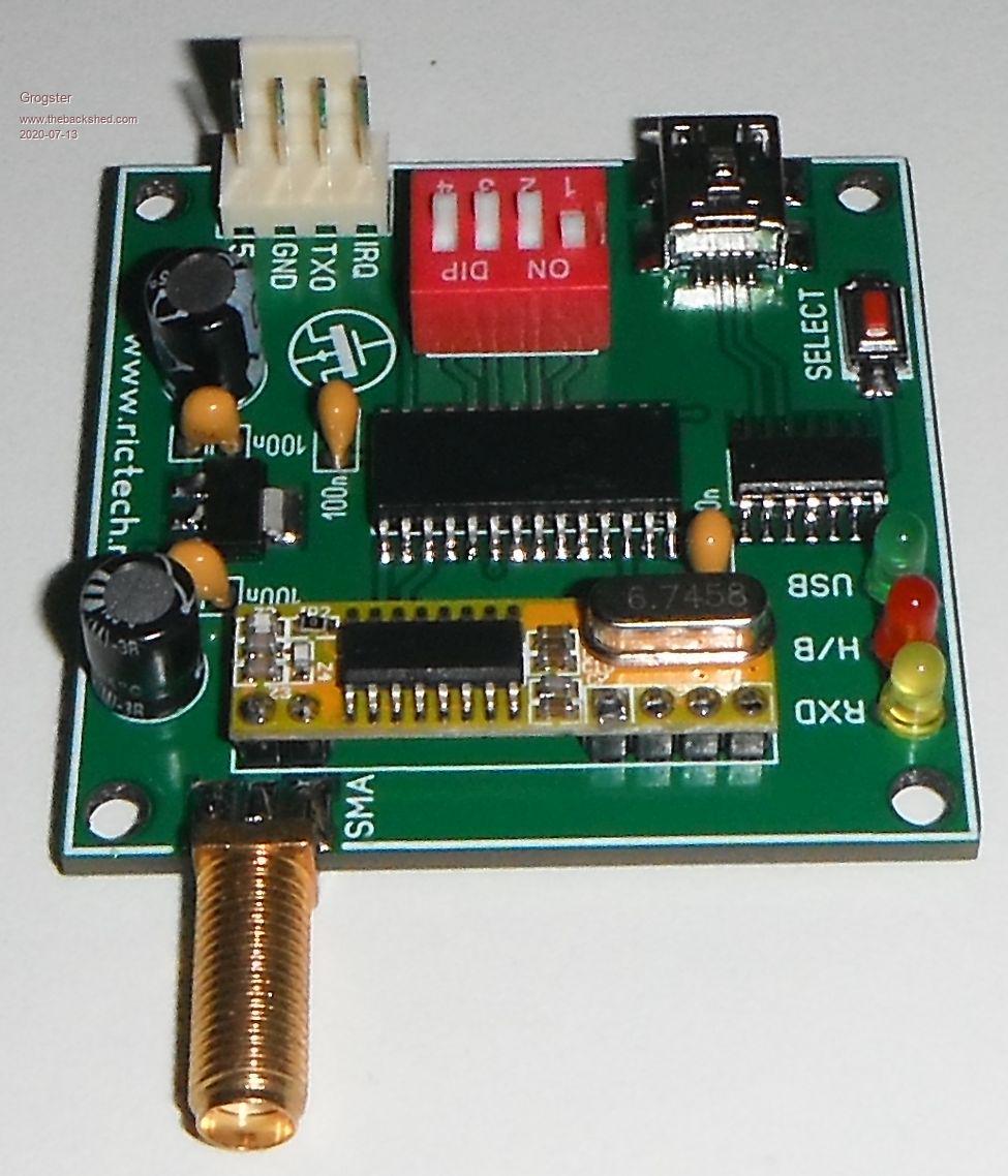

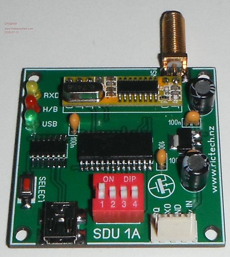

@ robert_rozee: Thanks for that extra excellent description of what is going on.  I owe you a big jug of the beer of your choice!
I have customised your latest code, so it now does everything I need:
  Quote  '==============================================
'SYN470R 433MHz/315MHz SDU (Smart Decoder Unit)
'Version 1A, [05/07/2020]: Inital code
'The heart of this code was written by Robert Rozee' on The BackShed Forums.
'Robert Rozee' is a clever man!  Thanks Rob! :)
'I have edited his testing code so that the MM2 simply decodes the data packet from the FOB, and forwards
'this to another system for processing.  This means that this MM2 chip is dedicated to only decoding the
'data packet from the FOB transmitter, and nothing else - apart from a couple of LED's and an IRQ line.
'This is primarily because decoding the data from the white-noise is reasonably CPU intensive under MMBASIC,
'so it is best to dedicate a MM2 chip solely to processing the transmissions from the FOB transmitters, and
'not to bother concentrating on anything else that might be happening at the same time - this, the main system
'can do. ;)
'The code can decode transmissions from most FOB transmitters, including the common 1527 and 2262/2264 encoders
'often found in wireless FOB buttons or other wireless transmitters these days.
'The code automatically deals with the white-noise on the receiver data output when there is no valid data.
'The IRQ line is pulsed for 100mS when a valid data packet is received and decoded, to signal to the host
'system that data has been received, although, most modern MCU's UART buffers can deal with this without needing

...and I have a PCB being made for it now:

PCB's have arrived, so I have built one.
Worked on the very first attempt.
Thanks to all who have help with this, but extra special thanks to robert.rozee for all his code that I was then able to customise to my purposes.
If this is something that anyone else would like to have, I can put it up on my website as either a finished programmed unit, or as a construction pack with gerbers, rob's code and BOM etc.
Reply here if you want either of those options.
