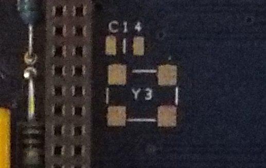

Thank you Peter for clarifying things ...
  matherp said  The SMD version uses a crystal oscillator rather than a crystal so will not see the issue. The solution to any video issues is to remove the crystal from the Waveshare and install the optional oscillator and capacitor on the motherboard. You need a 0705 8Mhz oscillator and a 1206 10nF capacitor.
Some (hopefully very few) Waveshare boards have this issue. I do not believe it is related to 400MHz or 480MHz. I can overclock a 400MHz part to 480MHz without any issue. It may be a crystal quality issue or some variance in the load capacitors. The issue is definitely on the Waveshare and not related to whether you are using a V2.1 (upright resistors) or V3.0(resistor pack) motherboard.
I was wondering if it might be Waveshare related, and was considering getting another Waveshare to test/compare.  Just my luck to get a rogue board.
I note your comments regarding the crystal and will order myself the parts for the oscillator mod.
Your help with this is very much appreciated.

  matherp said  You need a 0705 8Mhz oscillator and a 1206 10nF capacitor.
Peter, are these the correct parts you referred to above?
LFSPXO018045
Oscillator, Crystal, 8 MHz, 50 ppm, SMD, 7mm x 5mm, 3.3 V, CFPS-73 Series
https://uk.farnell.com/iqd-frequency-products/lfspxo018045/crystal-oscillator-smd-8mhz/dp/9713468?st=0705%208Mhz%20oscillator
http://www.farnell.com/datasheets/2551800.pdf
Size: L: 3.2mm W: 1.6mm H: 0.55mm
Footprint: SMD 1206
Package formation: SMD tape
100nF: 16V +/- 10%
https://www.ebay.co.uk/itm/1206-SMD-Capacitors-90-Values-Available-10-Pack-UK-SELLER-Same-day-dispatch/264566930175?ssPageName=STRK%3AMEBIDX%3AIT&var=564323940840&_trksid=p2060353.m1438.l2649
eBay item number: 264566930175
Any idea which way round the Oscillator goes?
It does not appear to be marked on the v3.0 board or included in the schematics.
Your comments would be greatly appreciated.
Roy
(aka. Womble)
Posts: 12085
Posted: 02:27pm 12 Jul 2020
You can just see the pin 1 dot in your picture - top right
Parts should be fine. Be very careful soldering the oscillator that the solder doesn't wick up onto the case.
It will probably work even if you leave the crystal in place on the Waveshare but it does kill the crystal

Posted: 04:41pm 12 Jul 2020
  matherp said  You can just see the pin 1 dot in your picture - top right
Thanks for your prompt reply Peter.
I had missed the DOT in the picture

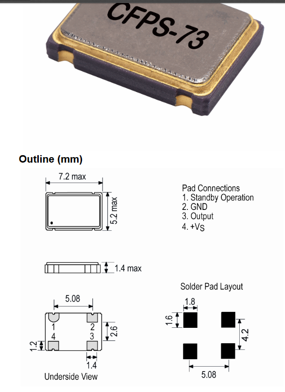

When I fitted the crystal oscillator.  Do this first!!! I tinned the pads on the pcb, used solder wick to make sure there was only the smallest amount of solder bulge on the pad, applied some liquid flux, and tacked each of the 4 corners with a hot needle point iron.  This did a neat job for me.  As mentioned previously, be very careful not to create a short with the metal lid on the oscillator.
Pin One on the oscillator is a different shaped pad on the underside of the device.
(I grabbed this from the datasheet)
Then I had a go at the "grain of rice" (capacitor).  The same technique worked, but it is not pretty or flush to the pcb.  The capacitor is not polarised and can go either way around.
A magnifying glass, tweezers to hold compnents in place and a pointy iron got the job done ... even for an amateur hobbyist like me.
Fitting these to the pcb before assembling the waveshare headers would be a good idea if you get the chance.
