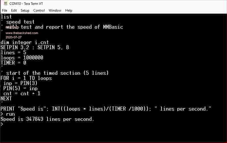

New record with 5.05.04RC12. berighteous' code now takes 10.78 seconds
Edited 2020-07-27 00:25 by matherp

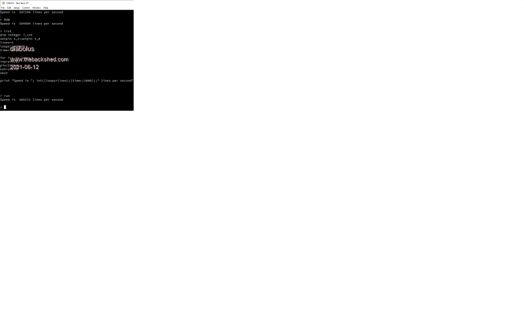

Necro thread bump, using the latest firmware posted in the last few days. Running a Circuit Gizmos Color Maximite 2 at 504Mhz.
Averages ~505,000
Edited 2021-06-12 12:19 by diabolus
