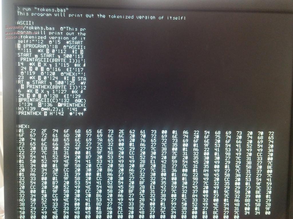

Posted: 05:01pm 20 Jul 2020
This simple program will print out the tokenized version of itself.
Note requires latest Beta Version posted in this thread (V5.05.04RC6 or later) for the MM.INFO(Program) command.
Print "This program will print out the tokenized version of itself:"
'Note that comments are completely skiped becuase they are not needed by the parser
Print
' Get the address of the program in memory
Start = MM.Info(program)
'Loop through the next 500 bytes and display as ASCII
Print "ASCII:"
X = 0
for i = Start to Start + 500
 PrintAscii(Peek(BYTE i));
 X = X + 1
 if X Mod 24 = 0 then Print
next i
Print
Print
'Loop through and display as HEX
Print "HEX:"
X = 0
 Y = PrintHex(Peek(BYTE i))
 X = X + 1
next i
' Sub and function used to show code in tokenized version
Sub PrintAscii(C)
 Print Chr$(C);
End Sub
Function PrintHex(H)
 Print Hex$(H,2),;
 PrintHex = H
End Function
Here is the output:
-Carl
