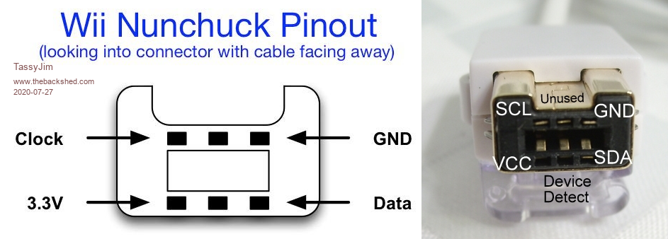

I'm finding conflicting information on the intertubes regarding the pins. Can someone confirm (or dis-) that when you are looking into that Wii/Nunchuk socket that has the pins which connect to a PCB, with the notch on the bottom, this is the layout of the socket pins?
Connector
Socket
| 1 2 3 |
| 4 5 6 |
|__---__|
1 Data I2C Data line
2 ACC used by the remote to detect presence of the Nunchuk
       (pin 2 and 3 shorted in Nunchuk to give 3.3V back to remote when Nunchuk is connected)
3 +3.3V VCC
4 GND Ground
5 N.C. No Connection
6 Clk Clock (100KHz)
Edited 2020-07-27 10:52 by lizby

Peter, thanks for pointing out my error re pullups. I should have known that.
Quazee, Your schematic lists pin 1 as being GND (as well as 3.3V) It is 3.3V
Lizby, I have seen pin 2 listed as the 3.3V but usually it's pin 3. Most cables will have pins 2 and 3 shorted as presence feedback so it shouldn't matter.
I would have prefered pin 2 as the VCC so that connecting the wrong way arround is not an issue but I guess the designers of the nunchuk reckoned the physical shape of the case cutout is sufficient.
I have seen some silly connectors in my day, but this would have to be one or the worst.

Thanks, Jim,
With respect to the notch, which is down in my diagram but up in yours, I think our labeling of the signals is the same. I don't know if there is any standard for numbering the pins.
Posts: 6570
Posted: 03:09am 27 Jul 2020
Most images I have seen put the notch on top.
The CMM2 has the notch on the bottom so that the connector fits in without having to put the CMM2 case on a pedestal.
