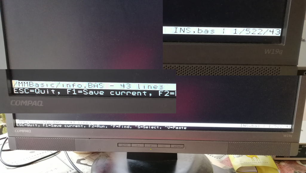

Hark0
Joined: 02/07/2020
Location: Spain
Posts: 31
Posted: 09:30am 03 Aug 2020
Hello, I think found another bug.
Try this:
1- Load or type very large program.
2- Move the cursor to last line of program... ex line 500 or more. F1 for save and exit.
3- Now F1 for files and F4 for load small program (10 or 20 lines)
* The editor loads and scroll the cursor to last edit line... sometimes showing black screen... (the small program are in top)... press PgUp for scroll cursor to top and view/edit the current program.
Edited 2020-08-03 19:31 by Hark0

Hark0
Joined: 02/07/2020
Location: Spain
Posts: 31
Posted: 09:45am 04 Aug 2020
  Quote  Can't replicate using your uinstructions
Please try again...
Load huge basic program.
Download with pgdown key to last line of huge source.
Load small program with files (F1 and F4).
The cursor are in the same line number of first program!!!!
Look the photo. (Retouched for best view).
You can see 522... this is the last line of my 1rt program.
and
I load a second small program with only 43 lines.
The cursor are in line 522 !!!
Edited 2020-08-04 19:46 by Hark0
ZX-UNO: ZX-Spectrum Clone with FPGA
Posts: 12254
Posted: 09:54am 04 Aug 2020
  Quote  Download with pgdown key to last line of huge source.
Then what? esc, F1, F6 run etc.
The instructions as written don't cause a problem for me. Entering the editor with a new file automatically resets the line pointer.
You will need to provide example files and absolutely specific instructions if I am to find the problem you are seeing
KeepIS
Joined: 13/10/2014
Posts: 2290
Posted: 11:26pm 04 Aug 2020
  Hark0 said  Hello, I think found another bug.
Try this:
I've see this a number of times when going to edit a small program of around 10 lines after working with program of around 300 to 600 lines.
On edit, I see what appears to be an empty program, pressing HOME twice takes the edit view back to the top left of the screen.
Unfortunately it never does it when I try to replicate it, usually happens after a long edit run cycle.
