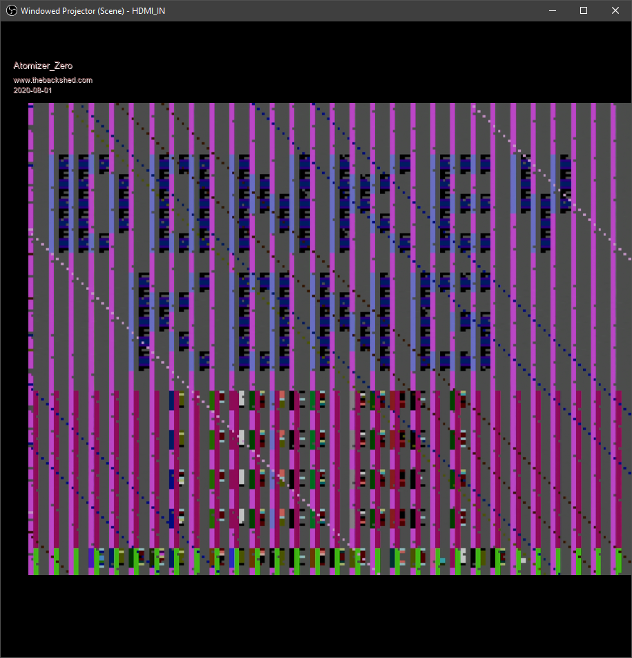

So, as is the case with everything in programming... you fix one bug, and a whole bunch more show up.
So, this looks AWFUL. But that's ok. It's ok because its showing that the palette was changed for the donkey kong text, the player 1 and 2 text and the nintendo copywrite info. because it wasn't changing the palette bank before, but now it is. I just have to fix the colours being loaded into the banks now..
For clarity. The Picture Processing Unit (PPU) has 64 colours. Only 32 can be loaded into 8 banks of 4 at a time. The palettes can be changed when the rendering is switched off (after the vblank flag gets set to 0). Thats how mario does it's flashing coins and blocks. It swaps the palette in one of the banks each frame.
There's a lot more to it than that of course, but that'll be enough to explain what I meant about the text getting different palettes.
