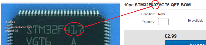

  matherp said  VG version is fine - just twice the FLASH. However there is something very suspicious about the pricing of these chips. Check this out and compare with a unit price of $10.51 from ST direct in volumes up to 500. The pricing of the VET board seems more possible - cheaper chip on a board that sells for more and made in huge volumes

  lizby said  Here's what the chip looks like, but I don't know what it might tell me:
Looking at the markings the chip is from week 48 from 2019. That is totally possible.
I only hope the "e3" marking does not imply these are engineering samples.

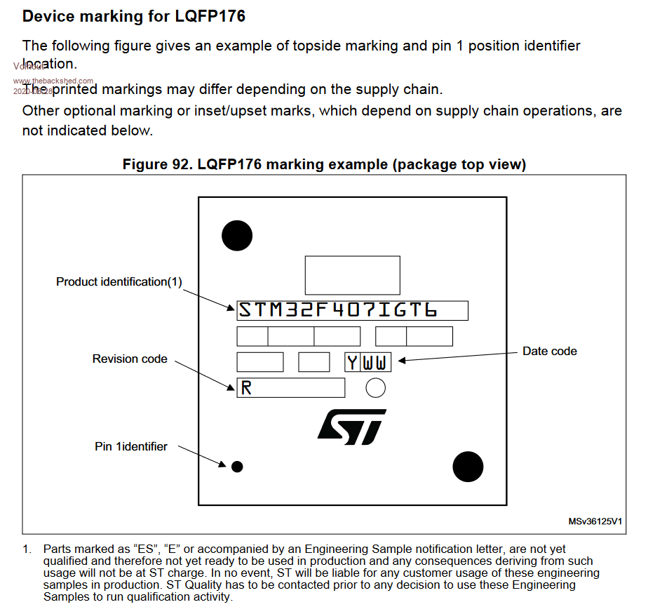

See below (this is the marking of an LPC176 package, so the 100pin will have different markings).
Posts: 4391
Posted: 04:05pm 28 Aug 2020
I think e3 is a JEDEC mark (for Sn, i.e. tin)
