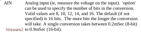

  Quote  The ' user ' manual doesn't even mention
' AIN ' .... Unless I ' m missing it someways ....
AIN isn't a command, look for it under SETPIN.
Bill
Posts: 3368
Posted: 01:04am 08 Aug 2020
AIN is not a command but a parameter to SETPIN where it is fully described.
ADC is a command - completely different.
Geoff
EDIT: Beaten to the answer again!
Edited 2020-08-08 11:05 by Geoffg

  Geoffg said  AIN is not a command but a parameter to SETPIN where it is fully described.
Geoff
O.K .... If someone would ?
Using ' ADC ' ... The code equivalent to :
10 SETPIN nn , AIN, 8
20 CLS
30 FOR x = 0 TO 255
40 y = PIN ( nn )
50 PIXEL x , y
60 NEXT x
70 GOTO 20

This code will use 14-bits per channel. Setting a faster ADC sample rate will automatically set a lower resolution.
It is Peter's real-time FFT demo code with all the interesting bits removed for clarity.
