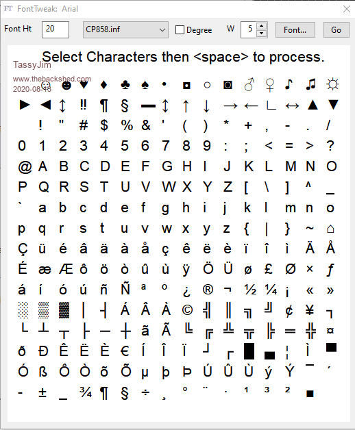

CodePage 858 has most, if not all the characters you are after.

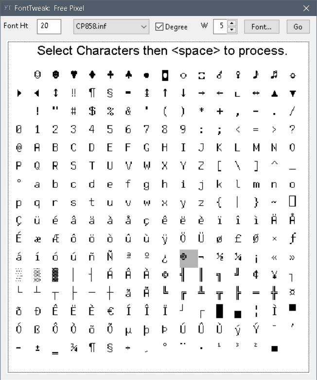

Edit3: I play with Fontweak... I find in my computer a clean good pixel font.
Hmmm I understand.... If I want a key with the symbol selected.... on key definition layout, I need to put the char code corresponding to correct character? Yes?
And save in, 8 bit C, 32 bit C, FNT for CMM2?
Best pixel resolution? 8x16 as default CMM2?
