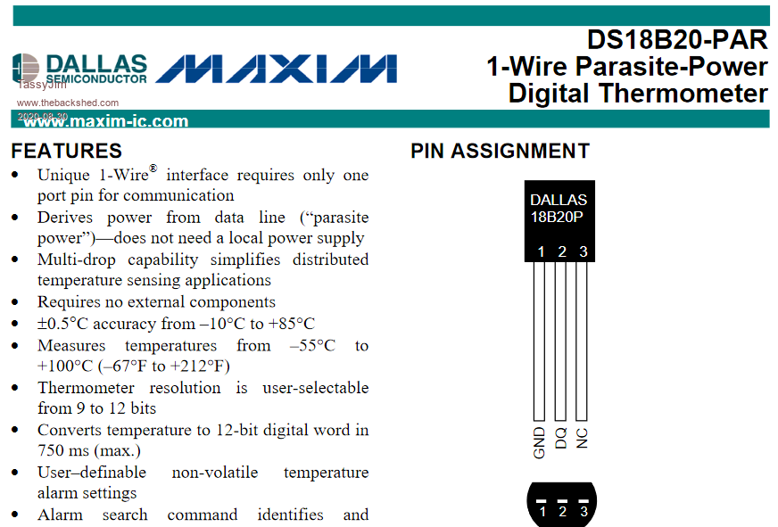

I still think your sensors are in parasitic mode.
Are they encased or can you see the designation on the sensor?
https://datasheets.maximintegrated.com/en/ds/DS18B20-PAR.pdf
Unfortunately, they use the same family code as the 'normal' ones so can't use software to see.
But they DO work OK so not a big deal.

OK, The "P's" have it!!!!!!!!!!!!!!!!!!!!!!!!
Checked out about a dozen of them. All P's
Trap for the ignorant...
Just tried on the CMM2 before reading your last message with the same results. (obviously)
May order some real ones to see how they go.
Thanks Jim. I hope it wasn't too much of a time wasting exercise for you.
Maybe need a note in the various manuals.
Brian

You learn something every day, however I'm now slightly confused.  Why do they make a special parasitic powered version when the "normal" version can work in both three wire and parasitic modes anyway?
Geoff
Chopperp
Joined: 03/01/2018
Posts: 1139
Posted: 08:06am 30 Aug 2020
Good question Geoff.
Looking up RS now.
Have in their blurb for a normal unit DS18B20+ :-
"They feature a 1-Wire communication interface and powered from that data line".
May have to give them a call check if they are the real deal or not.
Brian
ChopperP
Posts: 6623
I guess the parasitic is a few cents cheaper.
Or they have a strange warped sense of humor.

More playing 1-wire trying to get the grips with it.
For the Parasitic Mode (Power = 0) I added  SELECT CASE to set Tconv according to the Bit value (precision) in the ow_Tempr() function.
The timing values are the same as the manual which are on the conservative side of the specifications.
Full Code

results for 5 sensors. All "P's"
24
Power =  0  -0.25
Power =  0  28C02D81070000B9   111  24.5
Power =  0  28C02D81070000B9   212  24.5
Power =  0  28C02D81070000B9   412  24.5
Power =  0  28C02D81070000B9   812  24.375
Power =  0  28900381070000CD   111  24.5
Power =  0  28900381070000CD   212  24.25
Power =  0  28900381070000CD   412  24.375
Power =  0  28900381070000CD   812  24.3125
Power =  0  2838240107000040   112  24.5
Power =  0  2838240107000040   212  24.5
Power =  0  2838240107000040   412  24.5
Power =  0  2838240107000040   812  24.375
Power =  0  2832F9800700006B   112  24.5
Power =  0  2832F9800700006B   212  24.5
Power =  0  2832F9800700006B   412  24.375
Power =  0  2832F9800700006B   812  24.375
Power =  0  28750281070000C2   112  24
Power =  0  28750281070000C2   212  24.25
Power =  0  28750281070000C2   412  24.25
Power =  0  28750281070000C2   812  24.25
ChopperP
Posts: 6623
Posted: 09:34pm 01 Sep 2020
That works if you know that your attached devices are DS18B20s
Other variants have different timing choices and there are plenty of devices sold as DS18B20 that have questionable timing.
(I got into trouble calling them fakes)
I did think about fine tuning the timing but decided it was safer to stick with "slow and steady wins the race"
For your situation, changing the timing is worthwhile.
Chopperp
Joined: 03/01/2018
Posts: 1139
Posted: 10:47pm 01 Sep 2020
Yes, the mod is specific to my needs & they did work with shorter times.
I was wondering why all readings were taking the same length of time.
Using onewire with multiple devices means you have to get the codes & find out which one is which is obviously done individually but you need track of them. Also, if a sensor is replaced, it's code is needed & software updated accordingly.
One thing I found out yesterday when playing & reading the data sheets & the manual etc was about the strong pull-up that is used in the parasitic mode.
I was always under the impression that you really needed an external deice to do that. (not that I did).
It dawned on me that the data input gets changed to an output & set high for the period required. It even says this for flag 8 in Appendix C.
More playing.
Thanks.
Brian
