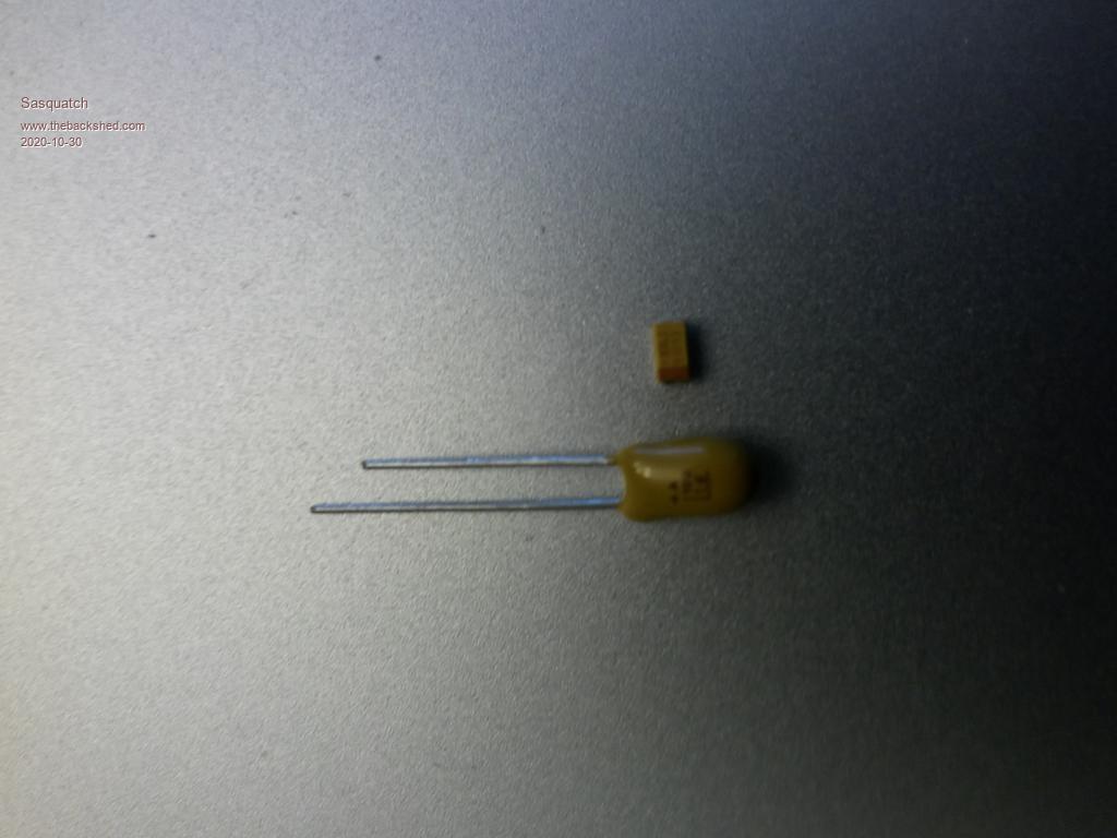

These are suitable replacements.  Sorry about the focus, that's about the best my phone camera can do.  The one with the "through hole" legs may be easier for a beginner to solder to the pads and is also a 16V rated part to avoid this happening again.  If you PM me your address I can put a couple in the mail for you!  As mentioned before, you will need to observe polarity or you will quickly fry the new part.  When in doubt "Google It"  If your power brick has a clean output, you might even get away without C5 for awhile.

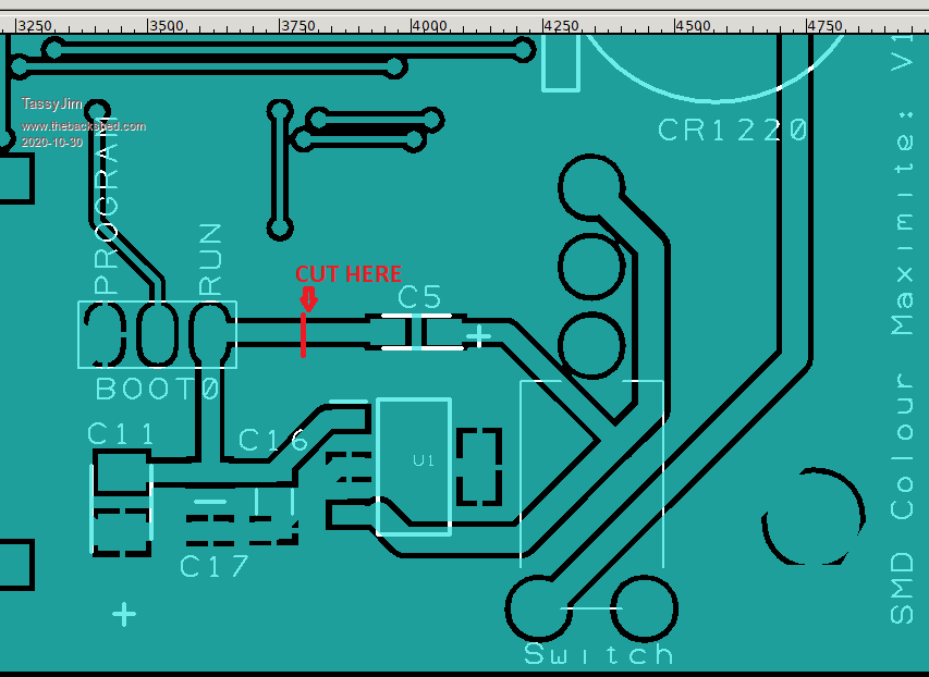

Please measure the voltages with the USB A-A cable in place.
If you can program the unit OK, the supply must be at least 4V to give enough voltage on the 3.3V side to allow programming to work. The regulator needs ~1.3V drop across it and the CPU probable will get away with 2.7V so 4V in 'should' work.
I don't think that the capacitor is faulty but as it's in the same circuit, measuring the voltages with power supplied via the A socket will confirm.
Faulty power supply, power supply limiting to 100mA, faulty cable, faulty B socket, faulty switch.

Posts: 6619
Posted: 01:32am 30 Oct 2020
  yock1960 said
  TassyJim said
  Quote  With power on checks 2.3V
I find it hard to believe that you are able to program the firmware with voltages that low!
That will put the CPUs supply at 1 volt.
Well, I'm only going by the messages from what the software says, I really have no idea.
Steve
I do believe you, I just am very surprised that the CPU will operate so far below its design minimum.
I am also surprised that your PC didn't complain about the excess current drawn from the USB. They usually have a resettable fuse to limit the drain.
Rather than removing the capacitor, you could cut the trace on it's negative side. That would take it out of service and be easy to re-instate if that's not the problem.
On these boards, the large areas of fill on the top side are 3.3V while the fill areas on the bottom are ground. That means it is difficult to isolate the 3.3V side of the regulator.
If you cut where I have indicated, you can easily scrape off the mask either side of the cut and restore the capacitor with a blob of solder.
I don't have a SMD board so I am only going by the gerber files but I think you should have room to perform the operation.

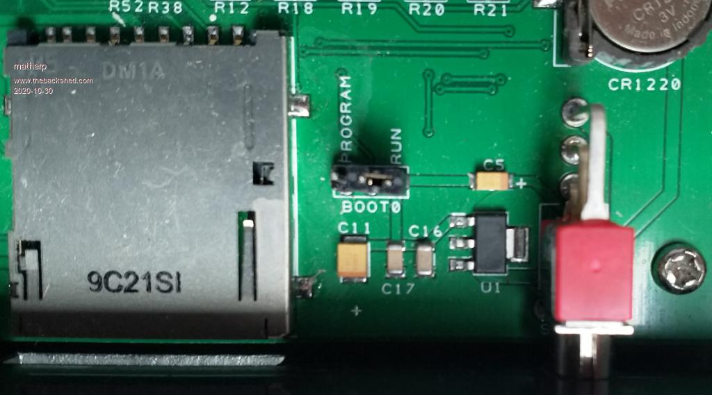

Well, it took several passes to cut through the trace and after I finally did, I had about 30 seconds of hope, as the busy light went out after powering on...but still no display. Voltage now checks about 1.7V on the center pin.
Another new development, is that when powering from the laptop to the B port, the device shows up as a com port now.
Further futzing around just now shows the busy light stays on after putting the run/prog jumper back on.
I installed Tera Term, set the port to 115200,8,1 and fired it up. Nothing. If I press the reset button while the terminal program is running, I get a few garbage characters back.
Cube programmer still connects...doesn't complain...I did not re-re-flash.
So, apparently, even though 9V should not have done this...it did...and the regulator is toast and maybe C5 and maybe...what else?
This was already going to be a challenge for me to remove and replace these components....time to punt?
