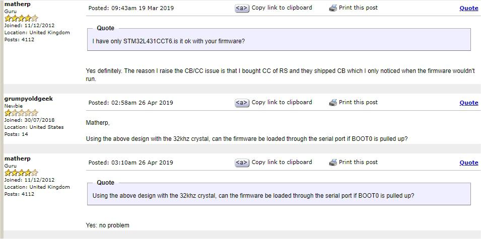

On a STM32L431CCT6 "48 pin Armmite" unprogrammed
Can I use "The Microbridge" to connect usb from the computer to pins
12 CONSOLE_TX A2
13 CONSOLE_RX A3
and then program it by dropping the bin file from the PC, or do I have to have one of those STM links to program this chip?
It won't be on a development board

Posts: 3853
Posted: 10:59pm 02 Nov 2020
  Mixtel90 said  You can't install or modify the firmware (MMBasic) via the console pins. You can change the BASIC program in this way though.
Re STM32L431CCT6, from this thread
Now this doesn't specifically say "microbridge", and I haven't used this particular L4 (just the Nucleos), but it seems worth a try.
One caveat--you're not likely to get much help with this module.
Edited 2020-11-03 09:11 by lizby
Posts: 4366
Posted: 07:28am 03 Nov 2020
ICSP is for PIC32, not for STM32.
The STM32 family has multiple ways of being programmed (bigger, newer parts have more options).
Posts: 9023
Posted: 10:50am 03 Nov 2020
Ah, right. Thanks lizby & John.
As I said, I'm not familiar with the Armmite. I thought it was fundamentally the same as a PIC-based device. Sorry if I misled you, lew247, I don't think I've been of much help there. :(
