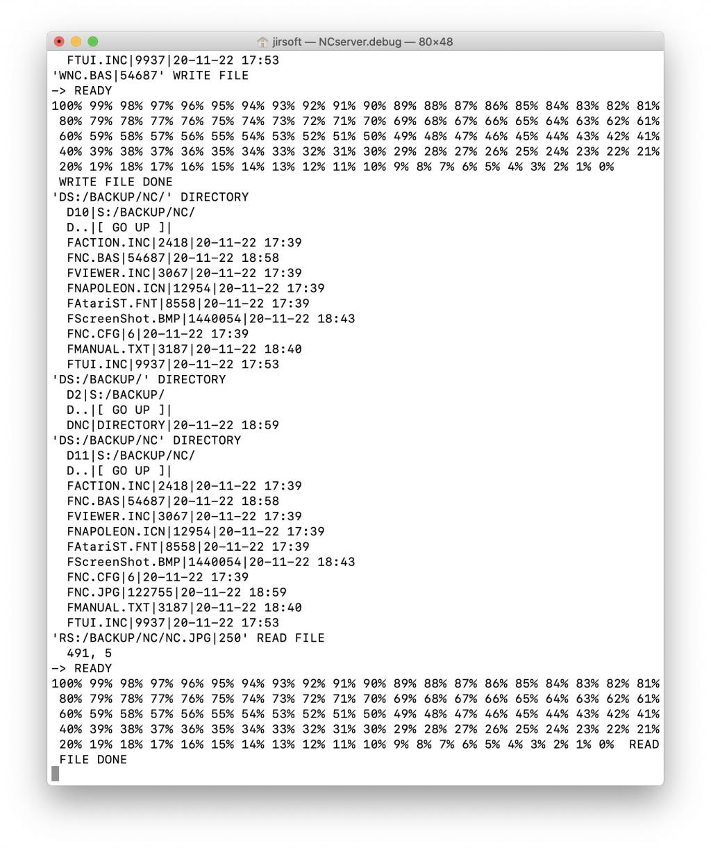

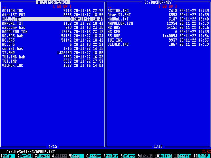

Some BIG news (at least for my workflow): NC now can copy between local SD card and server running on other machine connected with CMM2 through serial (now just tested on Mac), so you can BACKUP, EDIT on both, put easy to GIT...
You just need to use OPTION CONSOLE SCREEN + OPTION CONSOLE SAVE to leave serial for server, start server on PC and it's done. Tested with baud rate 230400 and it's usable.
I will prepare server description (so every can programmed his own in preferred language), in the meantime I will put to GITHub binary for Mac and try to write it in Python.

I have added simple server binaries for MacOS, Win/64 and Linux/64 as promised. Opens one debug window, directory where is it serving files is app directory, but it can be dropped any folder on window and this set the server root (can be seen in window title).

just uploaded python skeleton NCserver.py, that should be usable on all OS (where python is installed). Now it has just 2 basic functions: DIRECTORY and LIFE TEST, everything else is still missing. But at least you are able to test it with going through directories on the server...
Just modify 2 lines:
serial port
#modify to your port
ser = serial.Serial(
port='/dev/tty.usbmodem14101',
baudrate = 230400,
parity=serial.PARITY_NONE,
stopbits=serial.STOPBITS_ONE,
bytesize=serial.EIGHTBITS,
timeout=1
path to your server root
#modify to your path to server root
BASEDIR = "/Users/jirsoft/Documents/Maximite/NCserver/"
Enjoy!

So on the GitHub is full version of NCserver.py, that supports all 7 commands used by serial, so it works with NC on CMM2 just fine. I tried to play with serial speed and baud rate  - 691200 still works on both sides pretty good (speeds between 30 and 65 kB/s, so NC.BAS is copied in less than 2 seconds).
Now is supported in LOCAL/SERVER environment:
      FILE copy from, to and between server (last is both panes on server)
      MKDIR on server
      delete file or dir on server (folder could be full of files)
Still missing:
      rename file or dir on server (you can do it direct on Mac or copy to CMM2, rename and copy back   )
      move files between local and server (or on server), you can copy and delete
      copy full directory (that is the worst, is on my priority list)
      ACTION and VIEWER on server (I thing not so much needed, as Mac tools are usually there, but anyway...)
      better error display on CMM2 when something happens on server
Also in NC.BAS and TUI.INC are some bug fixes, newest version of NC is now 0.61.
Please if it is at least partially important for you, test it... I will then add some missing functionality to server side (for example full dir copy).
Enjoy!

Hi all NC users,
with version v0.80 is NC close to finishing from my side, I will try to iron it and of course fix the bugs, but from function amount are now missing just not so important things. Also NCserver.py is updated and needed fo new functionality.
What works:
info for DIRs on SD and SERVER
info for FILEs on SD
internal viewers on SD, external skeleton also on SD
DEBUG on/off on SD
copy of FILEs and DIRs on/from/to SD and SERVER (so SERVER can be already used as full backup)
move on SD
create DIR on SD and SERVER
delete DIRs and FILEs on SD and SERVER
rename DIRs and FILEs on SD and SERVER
create archive from directory to MAR file from SD to SD
create DIR from MAR archive from SD to SD
compress file to ARC file from SD to SD
uncompress ARC from file on SD to SD
simple configuration
What's missing:
move on/from/to SERVER, (replace with copy+delete), it's more because of security
file info for SERVER, will be too slow
viewers and actions on SERVER, will be too slow
HEX editor, I will still do it, but HEXedit will be anyway better
archive and compress to and from server, I'm looking for best way how to do it
Enjoy it!
