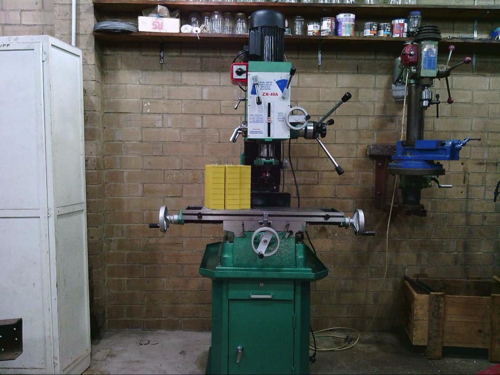

Don't want to hijack the thread, but for you machinery voyeurs here is a peep at my new toy.
Its fairly unique among the Chinese mills, because it has a six speed gearbox, with real gears. Most only give you direct drive and a motor speed controller.
The gearbox multiplies torque on the lower speeds, a motor controller does not, so heaps of grunt with only 1Hp.  Its also very solidly put together, pretty happy with it.

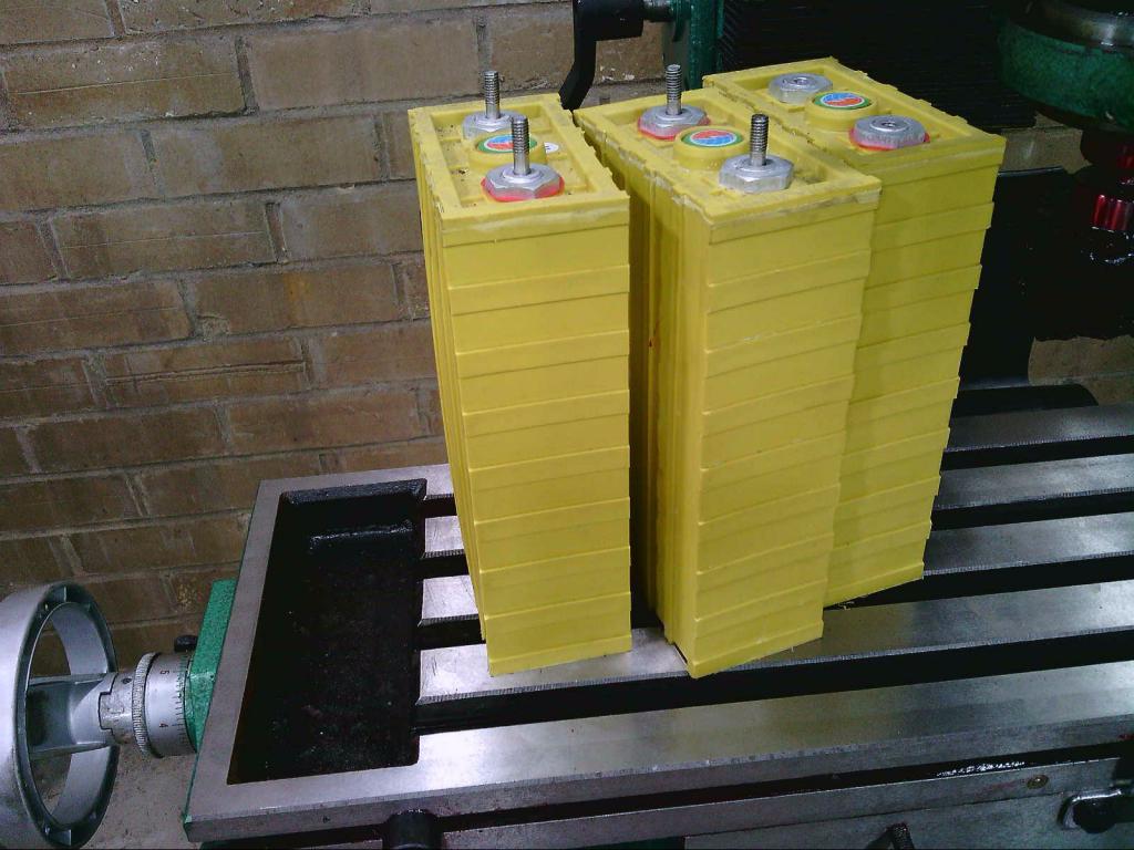

Here are my three deceased 60Ah Winston cells.  Note the slight swelling.
