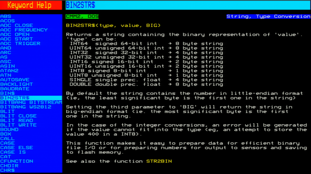

  vegipete said
  TassyJim said  The next stage will be to convert the HTML to text files so I can offer a more complete help system.
Unless some enterprising programmer steps forward with a rudimentary HTML renderer...
An idle thought, and only a mockup (well, it's hardcoded to give an idea rather than reading a file etc.)
I REALLY like this.

Posted: 07:49pm 21 Nov 2020
  CircuitGizmos said  I REALLY like this.
I'll give it some thought.  Essentially the left pane is an index, the top is a header and the content is the main pane.  With some work to split text across rows correctly and some controls to navigate, to would be an interesting distraction.
At best it would be something for the welcome tape (?), could never replace the printed documentation and would need to be easily maintainable from the published documentation.  It could help other language translations potentially though...

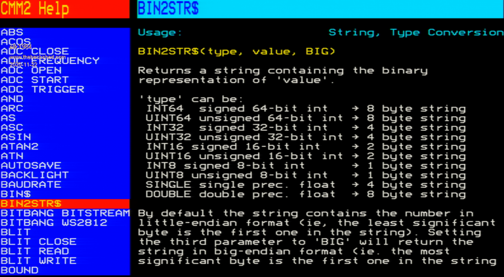

elk1984
Joined: 11/07/2020
Posts: 232
Posted: 09:25pm 21 Nov 2020
  vegipete said  Elk1984's idea looks very nice. Now, if that were a function key away in the editor, and a selected command could be pasted in at the cursor...
Add an effective search, especially one that can find words in the command description...
That would be cool, but I think it's beyond the scope of what is reasonable to build into the firmware (I'd wouldn't want to exchange a 3D library for a helptext system).
That said, I'll keep plugging away because my interest is piqued now.
@TassyJim.  Any problems with me using your work linked here as input for this?  I can't see complex items (like tables) making it in the first few cuts, but who knows where it will end up.
A slightly reworked look, with compatibility indicated in Green and function group (Type Conversion etc) in Blue.
I'm thinking a way of Tabbing between "Keyword Help", "Functions", "Commands", "Function Group", "Compatibility" etc.  The selected version would be shown top left as above.
