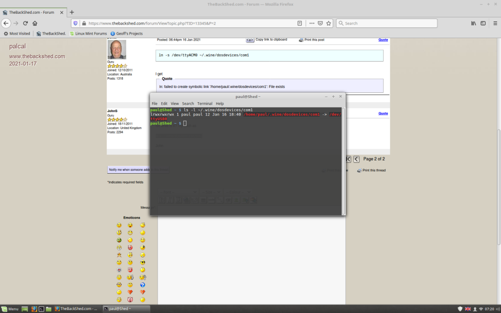

ln -s /dev/ttyACM0 ~/.wine/dosdevices/com1
I get
  Quote  ln: failed to create symbolic link '/home/paul/.wine/dosdevices/com1': File exists
Posts: 4386
Posted: 01:01pm 16 Jan 2021
So what is it? Try such as
ls -l ~/.wine/dosdevices/com1
palcal
Joined: 12/10/2011
Posts: 2053
Posted: 09:23pm 16 Jan 2021
@JohnS
That runs this is the result
But it seems to be trying to connect to USB0 not ACM0
Posts: 6624
Posted: 09:32pm 16 Jan 2021
If com1 is in use already, try a different com port number
ln -s /dev/ttyACM0 ~/.wine/dosdevices/com6
You can have lots of links defined and the corresponding port doesn't have to be in use.
Your existing com1 will be handy if you use a device that uses a standard USB-TTL converter instead of the microchip one.
