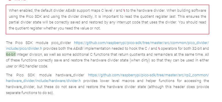

It does have integer divider peripherals, one per core, 8 cycles.  32-bit, I think.

  Quote  It does have integer divider peripherals, one per core, 8 cycles.  32-bit, I think.
Not if it is an M0+

It's not the M0 core that does division - it's the SIO peripheral - a bit like the old maths coprocessor chips, but integer only.  The SIO is described on page 24 of the 636 page datasheet.  There is one of these SIO peripherals for each of the cores.

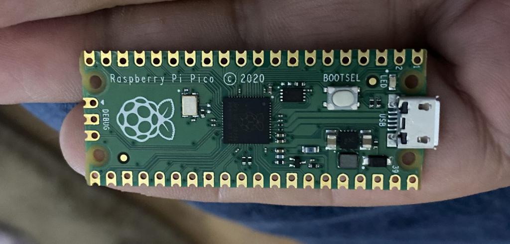

I thought that seeing this one has programmable io ports maybe it could be used instead of the Pi if it had mmbasic on it
Rp2040 datasheet
It has a Fast single-precision floating point library.
I don't know what these mean but its 64bit as well as 32
The  processor  implements  the  ARMv6-M  Thumb  instruction  set,  including  a  number  of  32-bit  instructions  that  useThumb-2 technology. The ARMv6-M instruction set comprises: All of the 16-bit Thumb instructions from ARMv7-M excluding CBZ, CBNZ and IT. The 32-bit Thumb instructions BL, DMB, DSB, ISB, MRS and MSR.
No idea what thumb is or does
It's also Tiny - this is on my index finger

Quote from the pico_c_sdk.pdf datasheet, page 25
The SDK includes optimized 32 and 64 bit division functions accelerated by the RP2040 hardware divider.
There are graphs in the datasheet showing that the 64-bit divides are typically twelve to twenty times faster than can be accomplished by the M0 core alone.

Posts: 11929
Posted: 03:16pm 23 Jan 2021
  Quote  There are graphs in the datasheet showing that the 64-bit divides are typically twelve to twenty times faster than can be accomplished by the M0 core alone.
Yes understood - but that is just integer divide - no FPU just some ROM software of unknown provenance

I don't think it's just ROM software.  It's a piece of hardware that does multiplication and division.
