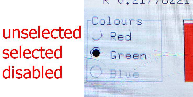

  lizby said
One thing I notice--perhaps it is because the the radio buttons are themselves red, green, and blue, but it's difficult to tell which one is selected.
OK, I think I got it - and you are right, it greatly improves clarity - Thanks!
the dot can still be any colour but it only shows when selected

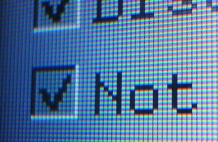

I've been playing around with it on my CMM2....with a few hiccups. In sub GetTouch, the GUI Cursor Mouse statement needs uncommented....that one had me scratching my head a bit.
After getting past that...oh...maybe add to the documentation that option mouse needs enabled for CMM2 users...I normally leave this off, since it's a bother to have to type 'mouse controller close' every time a program exits ungracefully. This also took me a few minutes to fathom.
Now for some nit picks...minor ones. As copied, the slider pointer is not redrawn after being moved, I fixed this by adding:
GUIObjDraw 71
inside the main loop. Not graceful...but it works. Also, the check/unchecked area for checkboxes doesn't seem to scale correctly to the frame around it...minor cosmetic issue. I haven't played with this...since I don't understand the usage of GUI Bitmap currently.

yock1960
Joined: 18/08/2020
Posts: 167
Posted: 11:14pm 05 Apr 2021
  CaptainBoing said  Thanks for the feedback Steve.
I have un-remmed the GUI CURSOR MOUSE in the CMM2 switch inside GetTouch - thanks. Not having a CMM2, that bit was done for me and I was putting it in "blind"
You are right about the box on the checkboxes - that was corrected in V0.63
The slider object is re-drawn as it is moved in the "cursor/touch down" section of ProcessTouch() - Case 4 immediately before the Loop at the end of the case (line 181 in my code here) - there should be no reason to redraw in your own program. I am testing on an F4 and it animates nicely, so if there is some difference in action on the CMM2, see if you can catch it and fix in ProcessTouch()
I am really pleased to see you playing and extending the functionality - precisely what this is meant for.
Okay, when was v0.63, all I see is page history by number/date. This could be another CMM2 specific issue...although one of TassyJim's images appears to show it fixed.
I think the slider redraw issue may be CMM2 related....how the mouse cursor is implemented...making this change (hiding the cursor while the slider is being moved) fixes it.

yock1960
Joined: 18/08/2020
Posts: 167
Posted: 11:20pm 05 Apr 2021
I just discovered what was apparently changed in the Checkbox draw routine. The GUI_bitmap statements were x+2,y+2, but are now x,y. If I put it back to x+2,y+2 the checkboxes are perfect on my CMM2.
Steve
CaptainBoing
Joined: 07/09/2016
Posts: 2171
Posted: 08:45am 06 Apr 2021
Thanks Steve.
I have updated the code to provide your cursor controls inside the slider touch processor.
Can't see that the checkbox needs any tweaking? Could you grab a closeup on the CMM2?
