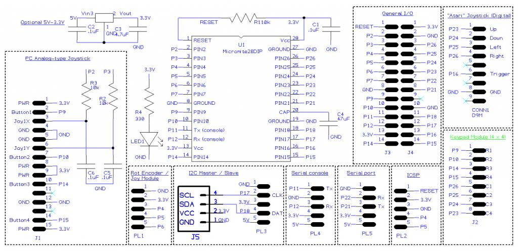

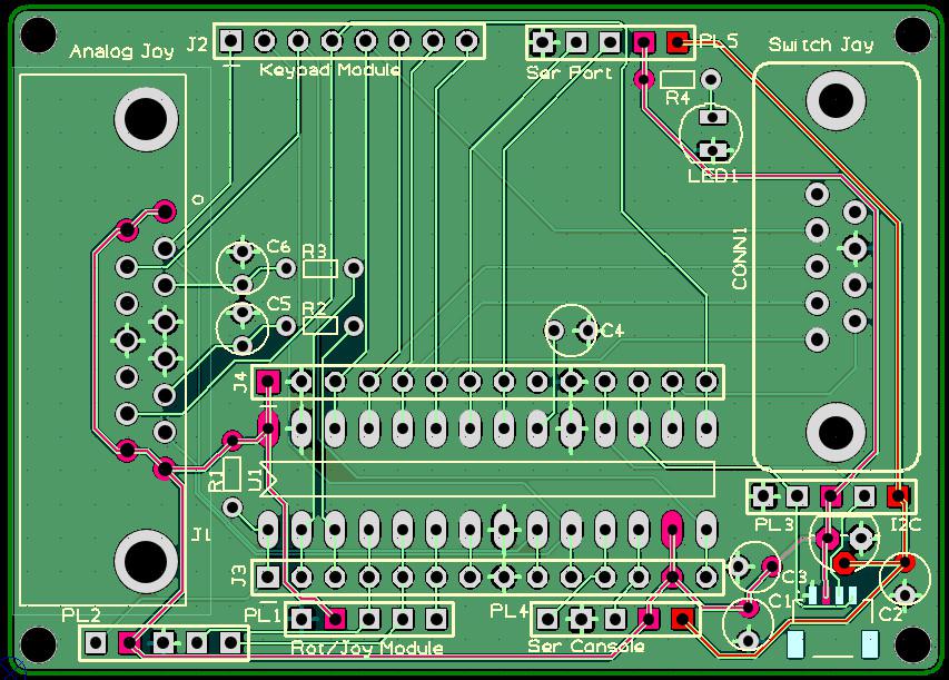

NONchuk1a Gerbers.zip
Next time I do a board order I will order some of these. Gerbers in Zip file if you wish to order them for yourself.

One thing I notice on the IBM joystick.
You have catered for all 4 buttons but only 2 axis.
Many IBM joysticks have a third throttle control and if you are emulating the Wii classic, there is the ability to support two joysticks using a joystick splitter cable.
If nothing else, can you bring the two other pins out to a couple of jumpers to allow for their use.

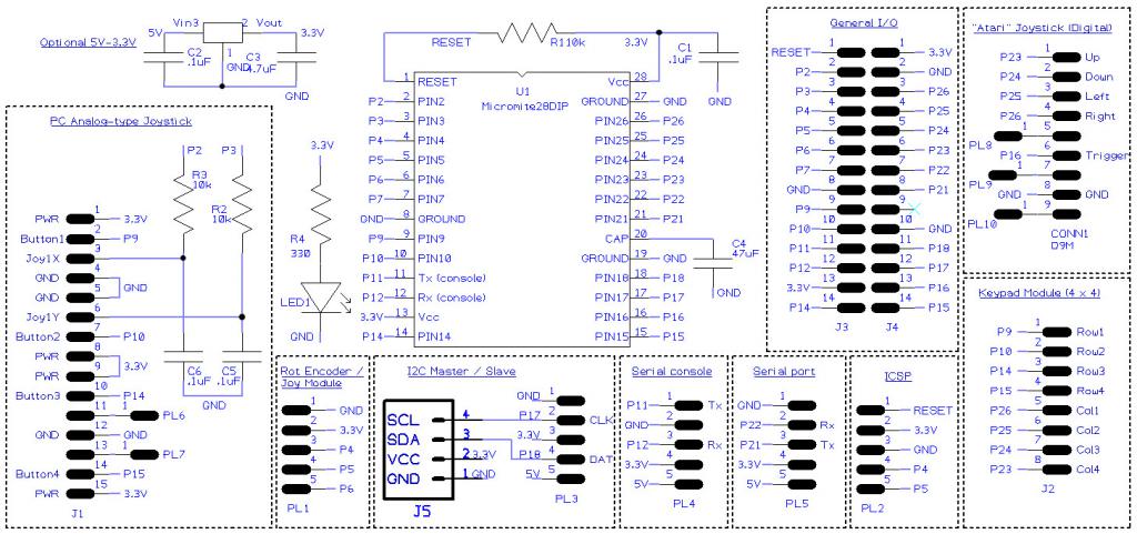

CircuitGizmos
Joined: 08/09/2011
Posts: 1427
Posted: 04:33pm 18 Apr 2021
  TassyJim said  One thing I notice on the IBM joystick.
Thank you, Jim! That is the type of info that I didn't have.

Posted: 04:52pm 20 Apr 2021
Updated:
NONchuk1a.zip
