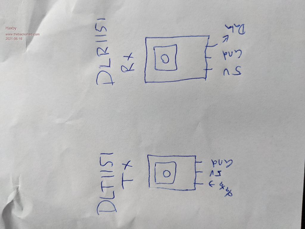

Posted: 05:17am 16 Jun 2021
Also the pinouts for the TX were hard to find.
After experimenting, this is what worked for me. Note these are the ones I bought from altronics to test, not the ones above which haven't arrived yet.

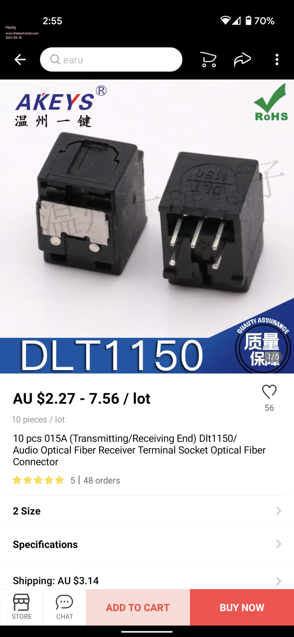

Posted: 03:09am 03 Jul 2021
I received the DLT1150 and DLR1150 from AliExpress yesterday.
The receivers do not function the same as the DLR1151 that I purchased from altronics.
They seem to have a minimum frequency that they operate well on, but lower than 600Hz I get noise in the trailing square wave.
I did a video here where I am altering the signal generator frequency built into my DSO. You can see noise on the signal when operating at lower frequencies, but not on higher frequencies.
The altronics bought DLR1151 does not have this issue.
Video:
here
Any thoughts?

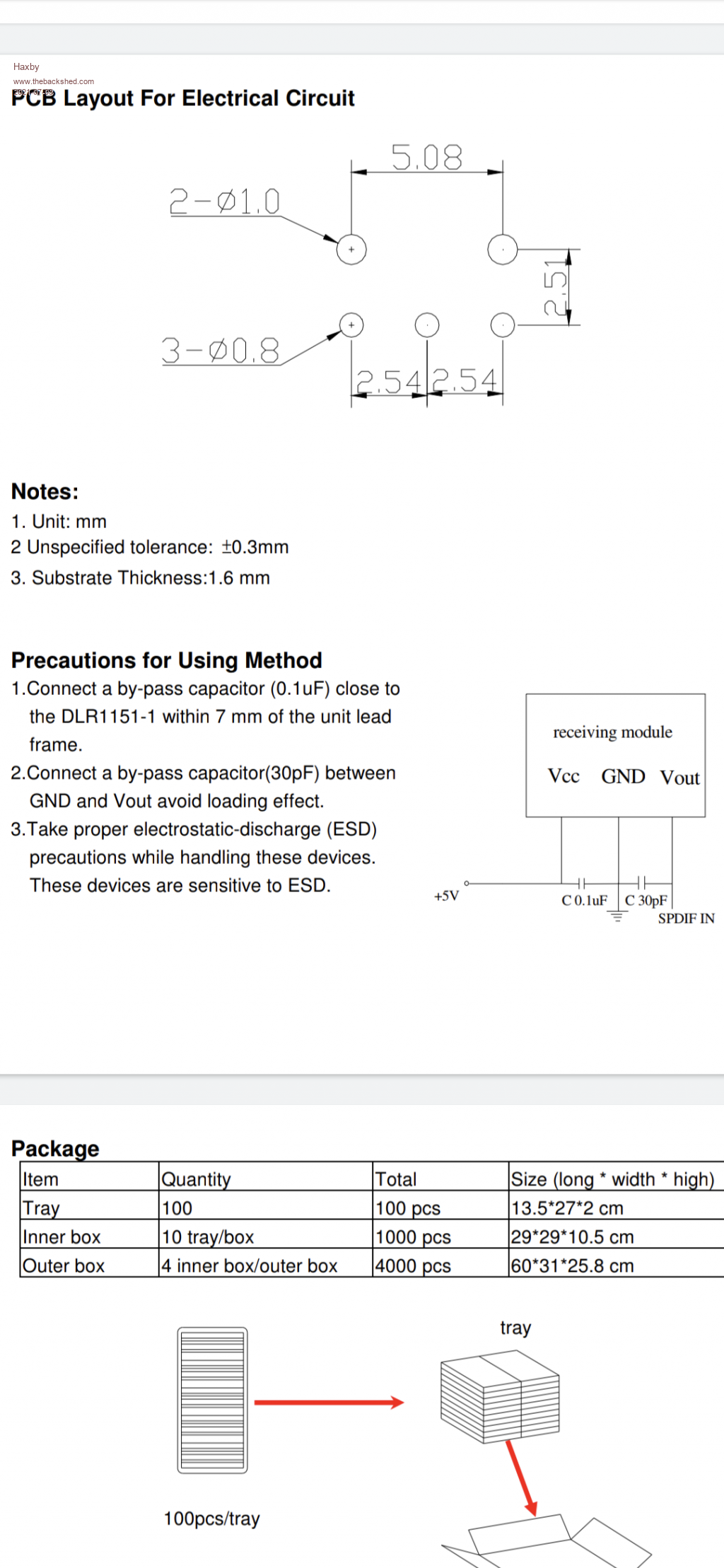

Posted: 05:54am 03 Jul 2021
I don't have a 30pf cap on hand. The data sheet says to put one between ground and data out. Maybe that's a clue? What is "loading effect"?
I DO have a decoupling 0.1uf cap on the power pins

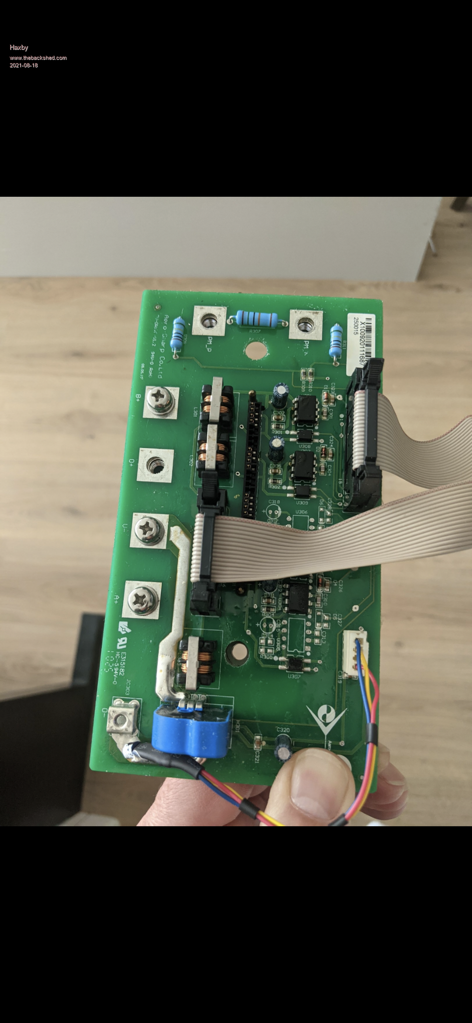

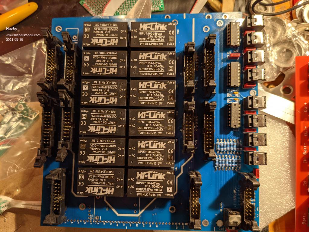

Ok I've been procrastinating a lot on this, as lockdown seems to drain my enthusiasm for everything but I thought it was time for an update.
I've changed tack somewhat and will be using the 50A igbts recycled from aero-sharp inverters.
It seems that the 1.5kw, 2kw and 3kw aerosharps all use the same igbt module. They have a small  aero-sharp PCB that mates with the igbt module. This PCB has the optocouplers that drive the igbt h bridge module.
There are 2 ribbon cables that come off the boards. One cable supplies the isolated 15v power supplies (3 rails) and the other cable supplies the logic signals and DESAT out.
So I designed a board that drives and controls 4 of these modules, which in turn is controlled by Poida's mega mini code.
Communication between these will be those optical toslink cables discussed in previous posts.
So for a 3 phase system, the tally will be 12 igbt modules with aero-sharp PCBs, connected to 3 of my blue boards....
Getting there, but as I say, I'm really struggling with motivation during lockdown!

Posted: 03:44am 03 May 2022
Just an update on the project.
Long story short is that the DLT1150 and DLR1150 toslink spdif optical transmitters and receivers are not suitable for this project.
While the data sheet states they work from DC, I have found in practice that these (probably clones) need some sort of minimum frequency.
Now the two I bought from altronics do work well, but the 100 odd ones I bought from Ali express are hit and miss.
The problem is that *Some* operate down to DC but others need a minimum frequency. I tested some more today and they needed 2khz as a minimum.
So they might all work reliably at let's say 5khz to 1mhz. But any lower, and they have a bunch of garbage at the trailing edge of the square wave.
Given that they would never be used at DC or very low frequency in the audio application that they are designed for, I can't really blame them for not working for me.
My suspicion is that the auto-gain circuitry built in to the optical sensors is expecting some minimum frequency of 100 kHz, and when it doesn't receive a "low" for a while, it turns down the sensitivity of the optodiode to a level where it gets one, one way or another.
Anyway now I'll have a think about either sourcing brand-name toslink parts, or moving to the more expensive but purpose built Tyco brand of digital optical TX and RX pairs.
