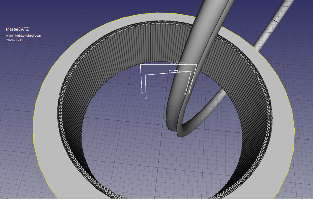

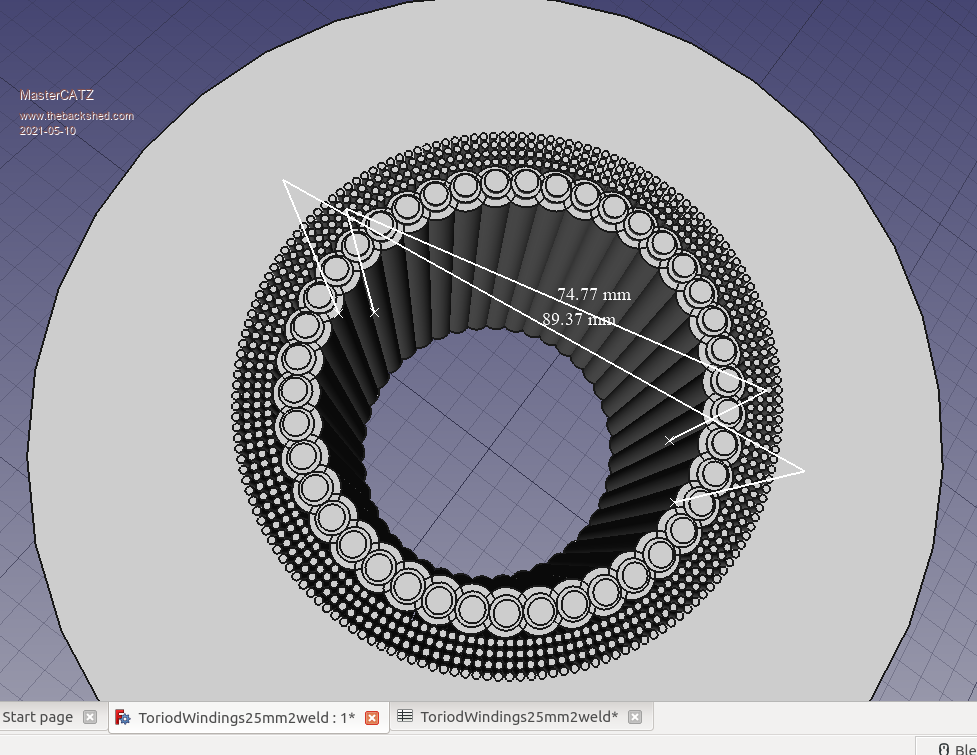

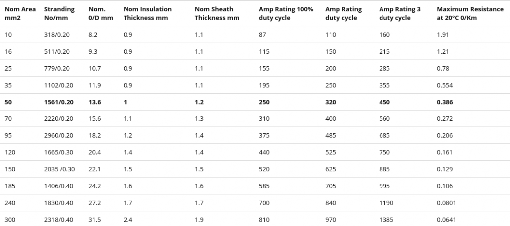

does anyone know the maximum size of the hole in the center ?
because it bugged me not having the primary making contact over all of the core
using the 50mm2 cable
I widened it up so I can use 25mm2 side by side single layer
it has a 90mm opening after being wound is is this bad?
or is having the center gap of the primaries the goal
50mm2 had 75mm gap
230mm external  130mm internal
70cm2
21 Primary Turns 2x 25mm in hand = 50mm2 circuit 250AMP continuous
166 Secondary Turns 4 Layers 2.54mm2 = 10.18mm2 circuit 50 AMP continuous
12kw continuous capable if cooled ?
1:7.9 ratio
Edited 2021-05-10 17:13 by MasterCATZ

Your winding drawings look good on paper, but and a big but, in practice you should use them as a guide only as the corners/90 degree bends, of the cable bulk out a bit and things through the hole get real tight.
Just get the cables through the hole, every time a cable passes through the hole it is One turn. Remember that anything in that hole, ie a holding bolt becomes a turn and is active so insulate it.
Size of hole, depends on the stack ie, the thickness, 130mm hole is okay you can stack a bit more and a 90mm hole left after winding would be heavenly, i normally find that i can just get a 12mm dia holding bolt though my wound toroids once finished.

please don't use steel or iron or anything metallic for that - it only invites eddy currents and increases your core losses.
I used 6mm plywood disks for that, worked a treat.

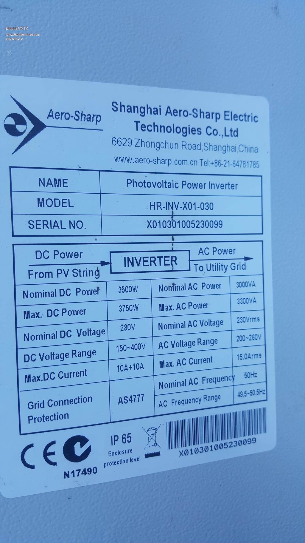

Ah that's an Aerosharp not Aerostar.
All good. Plenty of experts here on that brand.

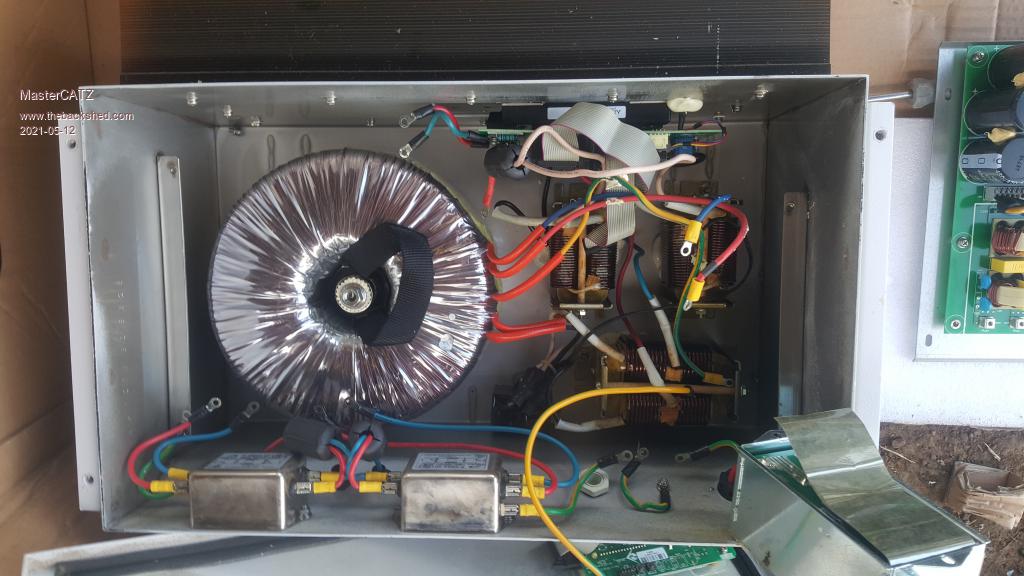

Getting the transformer out is easy! First disconnect all wires, then turn the box over, lift to about 600mm height then drop it on the ground! The toroid will dislodge and fall out. The screw and epoxy centre stay with the box.
That's how I did 7 of them so far and they all turned out great.
You might want to work up to 600mm height drops depending on how well it is stuck down. I'll video my next one.
I did mine on a grass lawn so there was no damage to the windings when it eventually popped out.
If you were to do it on concrete, you would want some styrofoam or something to catch the transformer.

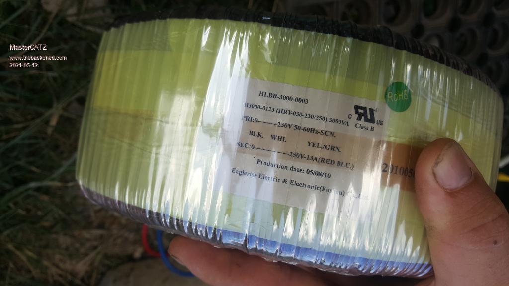

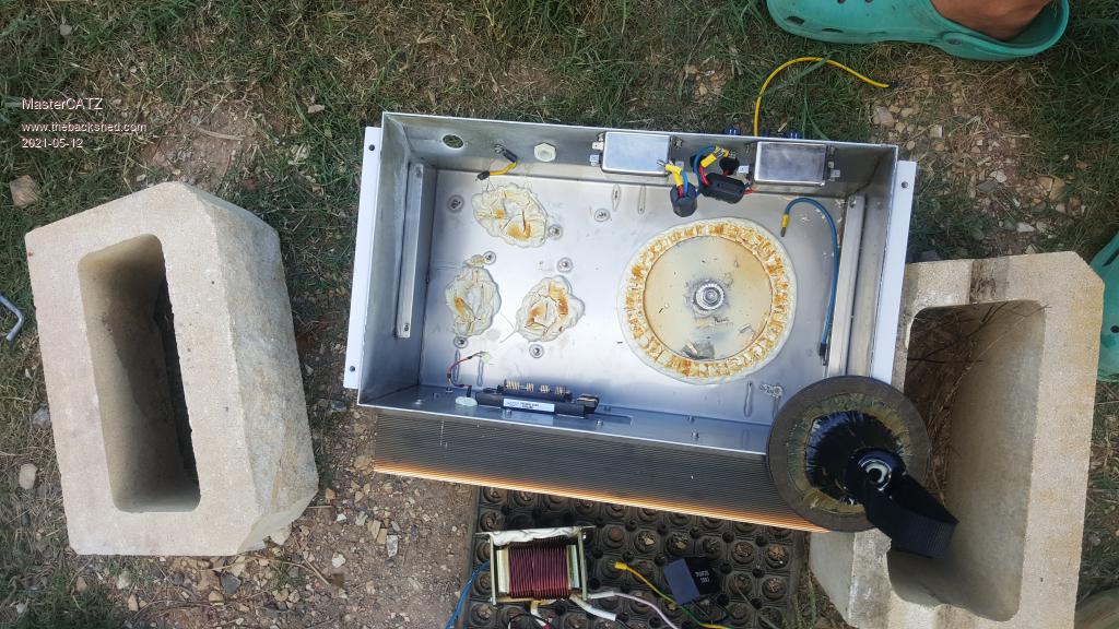

well we ended up getting the torch onto them and heating the box up
unfortunately I need a minimum of 5kw unless I can parallel the coils easily ?
any way to put the ozi inverter in another case to drive those coils inside their own separate inverter box's as is ?
or can ozi inverter be paralleled AC side ? can it couple ?
apart from that yes will be combining the cores
now I am wondering where I got Aerostar from
if a mod can fix the topic name to aerosharp that would be greatly appreciated
Edited 2021-05-12 18:16 by MasterCATZ
