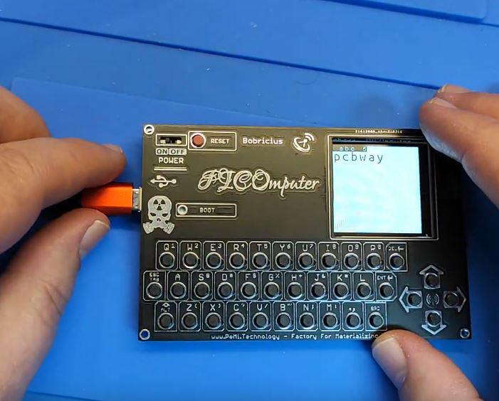

RP2040 with qwerty keyboard and display

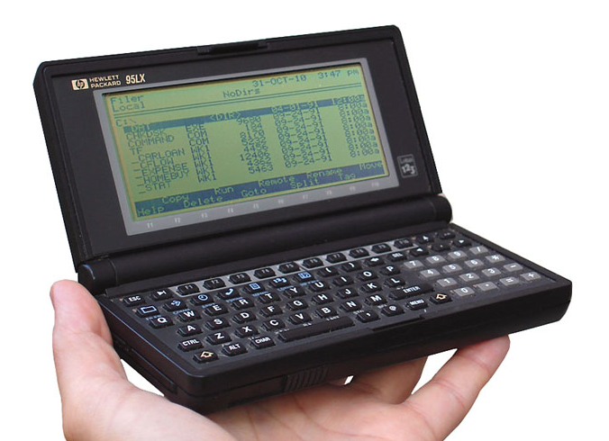

now an interesting possibility: hook two pico's together via their USB ports - the pico is capable of acting as a USB host. pico 'A' (as a CDC device) could run mmbasic, with all the I/O pins free, while pico 'B' (as a USB host) could act as a VT100ish terminal, drive an LCD screen, and scan a matrix keyboard. this terminal emulation could be written in python, largely using existing code that is already out there.
this could give you a neat little pocket computer in a form-factor similar to this:
rob   :-)
Edited 2021-05-29 01:09 by robert.rozee
Posts: 4388
Posted: 03:35pm 28 May 2021
  robert.rozee said  ... this could give you a neat little pocket computer in a form-factor similar to this ...
Nice. Though you might save yourself a lot of trouble by buying a second-hand Psion Series 5 on ebay, OPL was a neat BASIC inspired language.
Edited 2021-05-29 01:35 by thwill

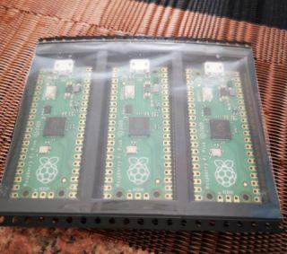

woot! less than 24 hours delivered.
just need some firmware... now what should I use? ...

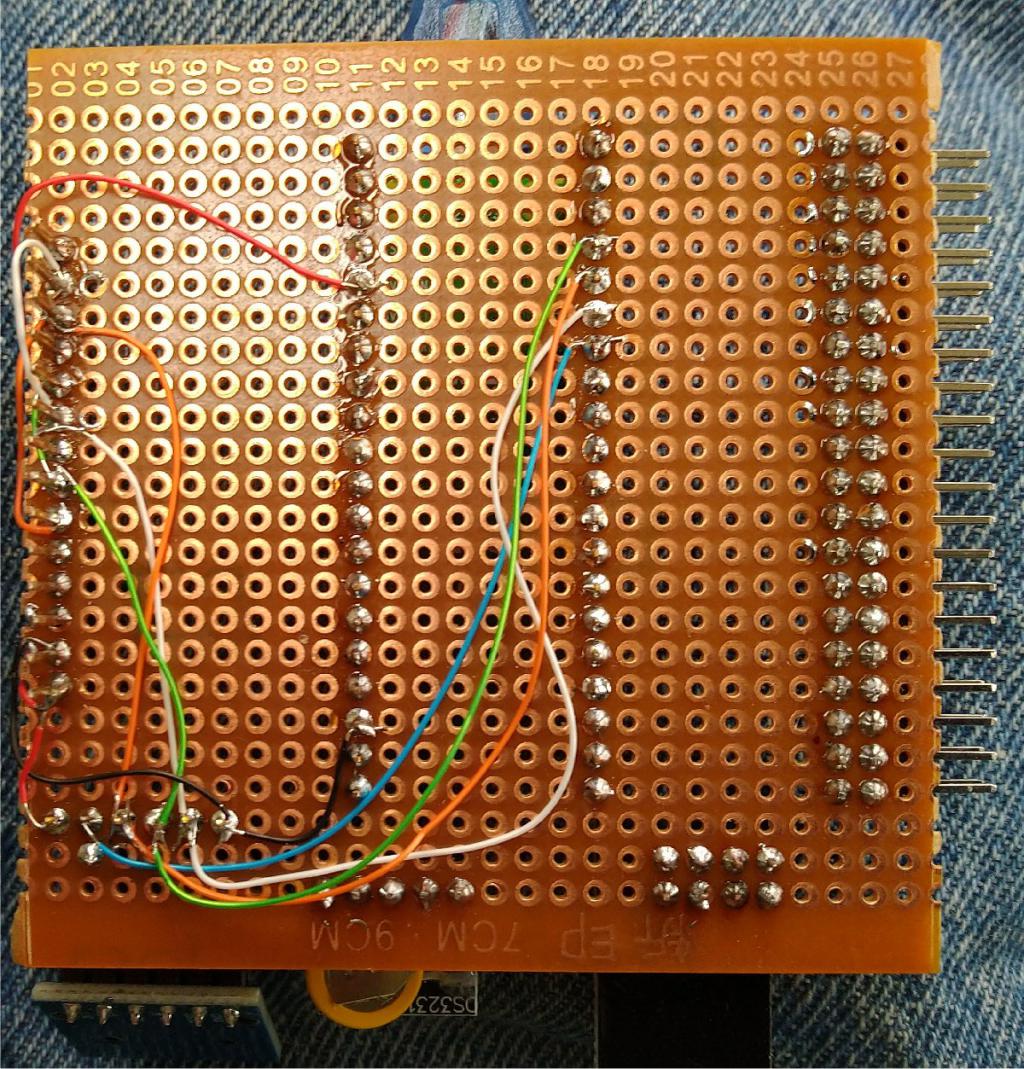

I used this micro sd module because I had some.
Wiring:
