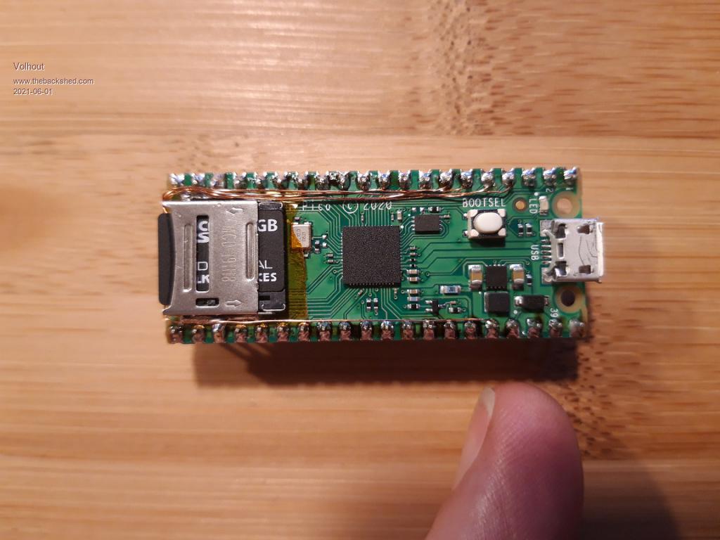

Posts: 6134
Posted: 07:13am 01 Jun 2021
SD card... it just fits...
Posts: 9152
Posted: 07:48am 01 Jun 2021
Wow....
We are not worthy!  lol
Nice bit of wiring there. :)
