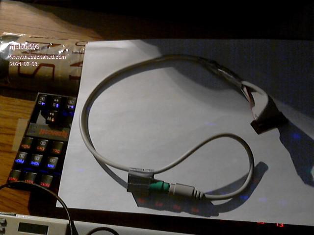

Hi all.  I have ordered a 2ed Gen system from MicroMite.org and was interested in the ESP8266 ESP01 add-on to give me a wireless connection to my PC. I have a few questions about what I need to do to get that working when I have both of them arrive.
1. I ordered an ESP8266 ESP01S module and is that OK for this use.  I did not knoww that the ESP01S was different in that it had preinstalled pull-down resistors, or an I wrong?  Should I have gotten an ESP01 instead?
2. What do I need to program into the ESP01S for this to work or is the stock firmware on them all that is needed and the AT commands are what I will interact with.
3. The pictures of the standard PCB shown here show the 8 pin holes for the ESP01. Will, there be enough room for a set of female pin headers to be soldered in and the ESP01 still fit inside the case, or will I need to solder it right to the board.  I would rather use the pin headers.
PS:
As far as the optional Mouse chip what needs to be done for that to be added?  I have a perfectly fine 40 pin mouse cable that works for PS/2 Mouse but would love to have the USB functionality instead.
Thanks for any help you can give.

  mclout999 said  Hi all.  I have ordered a 2ed Gen system from MicroMite.org and was interested in the ESP8266 ESP01 add-on to give me a wireless connection to my PC. I have a few questions about what I need to do to get that working when I have both of them arrive.
PS:
The ESP01S should be OK provided the pinout is the same as the original.
It should come with the AT firmware and that should be OK depending on what you intend to use it for.
There are many different firmwares to choose from, all with different uses.
If you decide to fit a Hobytronics IC to use USB mice, it will be very difficult to go back to PS/2 mice. It would require removing the Hobbytronics chip.
This are also a couple of jumpers to solder but it is the chip that is the main thing if you elect to use it.
PS/2 mice only need a passive adapter to fit the USB socket so much simpler (and cheaper) The Microsoft Classic and most USB/PS2 mice don't even need that, just plug them in.
Edit
To give more details.
The ESP socket connects to com2 so you could also run the same programs on the CMM2 G1 using the 40 pin connector.
If you do insert the ESP module, that will tie up com2 for other use.
Similarly, the Hobbytronics chip is connected to I2C2 so you could use a Hobbytronics module connected to the 40 pin connector via any I2C lines on either G1 or G2 systems. That way, you could experiment with USB and PS/2 mice without any problems.
Edited 2021-07-08 10:30 by TassyJim

Thanks for responding Jim.  I would like to have a wireless connection to my PC for transfers and coding with MMEdit. Like I said I have a nice PS/2 mouse cable that I use but would like to free up the 40 pin connector for other things and would like a simple USB mouse connection. I can not tell from what I have found so far exactly how to install the HT mouse chip or if there are any other components that are needed to install to use it.
This is a very simple clean solution for a PS/2 mouse with that adapter added to let me use USB-PS/2 mice. I later added a overclock temp switch pigtail so I could use the overclock at will witch is no longer necessary. I need to remove that thing.  I just thought about something.  Will I have to rewire this because the 40  pin connector has been flipped to match the RPI pinout and key notch?
