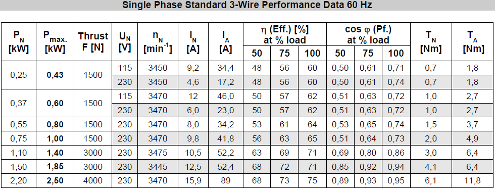

Some of the tables only look at Electrical power.
With a 1/2 HP motor the 1/2 HP may refer to mechanical power out.
There is a big difference.
This table is from my Franklin Electric bore pump manual. (3 wire includes earth)
I have used the 60Hz table to make our USA friends feel the love.
Taking the 1/2 HP (0.37kW) as an example.
Power in = Volts X amps X power factor
Power out = Power in X efficiency
The table lists nominal power as 0.37kW and Pmax at 0.60kW
For 115V, the current is 12 amps with starting current of 46 amps (That would be worst case)
At 100% load
Power in  = 115 x 12 x 0.72 = 993.6 W
Power out = 996.3 x 0.62    = 616 W ** matches the 0.6 kW Pmax in the table
At 50% load
Power in  = 115 x 12 x 0.51 = 703.8 W
Power out = 703.8 x 0.50    = 352 W

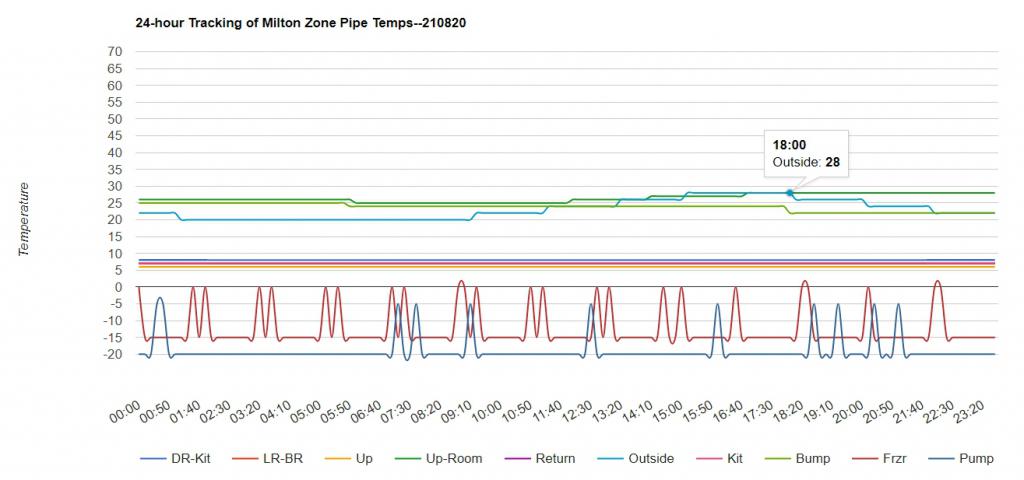

Here is my tracking chart with the water pump added. It's the blue line rising from -20 -- since I'm just looking at on/off, I arbitrarily set -20 as off and -5 as on. Similarly, the freezer off is -15 and on is 0.
The chart shows a curve, which isn't accurate. Each horizontal period of resolution is 6 minutes. The pump runs for about 1 minute. It might be better represented as a vertical line, but I don't know how to do that with this google chart.
The DR-Kit, LR-BR, and Up lines represent temperatures of the hot water feed pipes for my 3 heating zones. They're flatlined here because it's summer, and no heat is called for.
