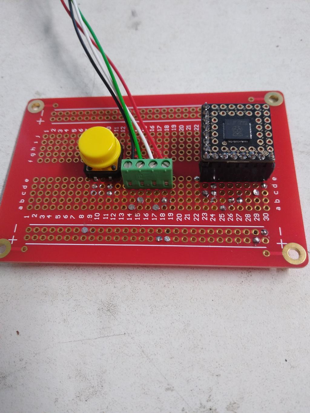

I am reminded to attach all ground pins on the PicoMite .
I only have one attached
my site
Posts: 9027
Posted: 04:24pm 03 Nov 2021
I usually ground one or two on each side. I don't bother otherwise. The AGND does need to be "clean" for best results when using the analogue inputs. It's not connected to the main ground, it's attached to a separate ground plane beneath the analogue lines and, I think, part of the RP2040.

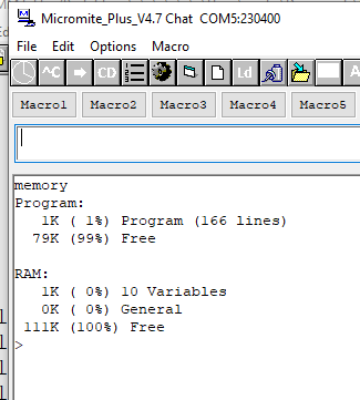

This works perfectly
Edited 2021-11-05 00:14 by Tinine
Posts: 3853
Posted: 02:28pm 04 Nov 2021
  Tinine said  This works perfectly
What are we looking at here?
Only when I noted what the image file is named do I have much of a clue: PGA2040 Running MMBasic.PNG (aside from the raspberry pi logo on the chip).

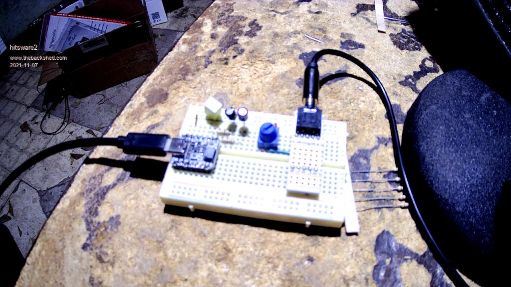

Happy to say !
This One
Working fine ( V5.07.01b5.uf2 )
Evedently I got my wires crossed with the first one
my site
