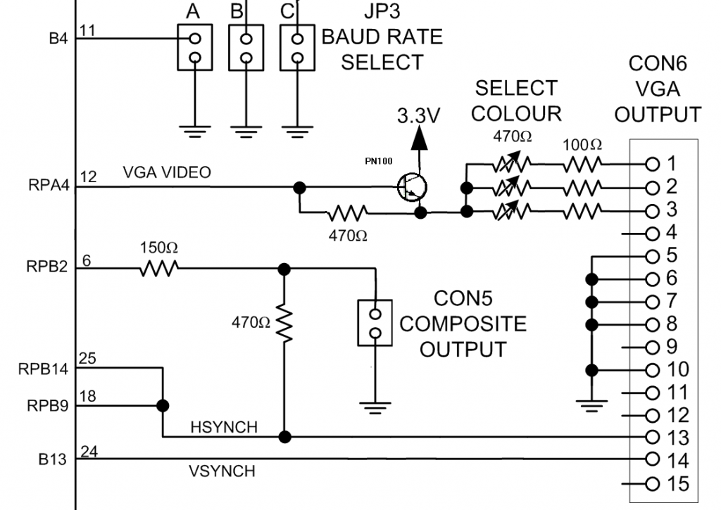

Posts: 3454
Posted: 11:27pm 28 Nov 2021
"Can the VGA output drive more then one of the colour inputs to the VGA monitor?"
On Geoff's ASCII terminal I used an NPN emitter follower to allow it to drive all colours.

Posts: 10140
Posted: 03:12am 29 Nov 2021
  phil99 said  "Can the VGA output drive more then one of the colour inputs to the VGA monitor?"
Owwww - that's a clever idea, and so simple.
Did you just use a 75R emitter-ground resistor for the load?
Did you have one NPN per colour channel, or just one NPN driving all three?
Your post would seem to suggest just one NPN driving up to all three...

Posts: 3454
Posted: 04:57am 29 Nov 2021
@Grogster
Here is what I used.

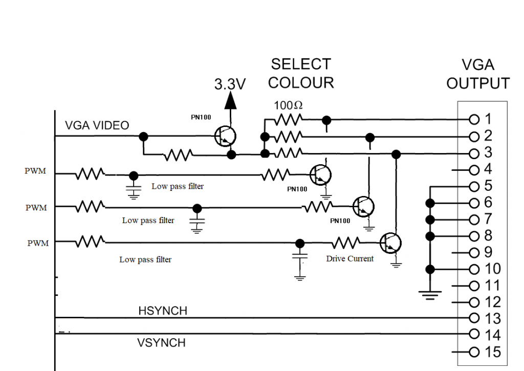

Posts: 3454
Posted: 06:19am 29 Nov 2021
Analogue software colour control might be as easy as using 3 PWM signals to shunt signal from the three VGA colour pins. Rudimentary colour graphics done by changing the colour mix between graphic commands.
