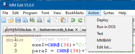

Posted: 10:11pm 02 Feb 2022
Hi Jim,
I'm a great fan of MMEdit and have switched to version 5 for the Picomite (on a Windows 10 PC).
I have some questions if I may:
- to install it I've just copied the new (overwriting the old) files in . . .\CCcom\MMedit\MMedit.exe - my shortcut is to that file. Is that correct?
- each time it fires up it loads the CMM2 syntax and has no "Recent Files" (I'm using Picomite syntax)
- how do I save preferences such as last used terminal size, syntax, comms etc
- can one 'set the time on load' (when I get my project working I will use either GPS or RTC but it would be nice in the meantime)?
- to 'Crunch on Load' one now crunches to a new file and then uploads that to the device - yes?
Thanks for a great program,
Andrew
Posts: 6624
Posted: 11:01pm 02 Feb 2022
  Andrew_G said  Hi Jim,
Andrew
I will put out a new version 'very soon'. There will be the portable versions as well as an installer.
V5 will install as a totally different program to earlier versions so it should not go into the old locations.
The main delay is my slow progress on the help file.
Here is a 64bit portable version with the help still not updated.
64bit is much less likely to fall foul of the antivirus crapware.
MMedit5_portable.zip
Just extract to a writable location and make a shortcut to the two exe files.
The data folder is a subfolder of the main folder for the portable versions. The ini files are in there.
try
'target port\com9:115200 s\picomite settime\
as the first line of your code with the com  port changed to suit.
Edited 2022-02-03 09:07 by TassyJim

Posted: 01:14am 03 Feb 2022
Hi Jim,
I currently have .BAS files associated with MMEdit and run the MMBasic program by clicking on the gear icon or the running man as appropriate. I would like to be able to associate .BAS programs with both MMEdit and MMBasic.exe but Windows doesn't allow that.
I was thinking of either another batch file to choose between MMEdit and MMBasic and maybe Notepad as well or just right clicking on the .BAS file and choosing 'Open with' (probably easier).
Do you have an alternate?
Is it possible to use the one instance of MMEdit with either version of MMBasic.exe? Somehow choosing which version to run.
Bill
Posts: 3411
Posted: 03:42am 03 Feb 2022
Something that may be worth a try.
Put shortcuts to MMBasic and MMEdit side by side on the desktop then drag-n-drop the *.bas file onto the one you want.
Not tested for the above but works for other apps.
Posts: 6624
Posted: 04:58am 03 Feb 2022
  Turbo46 said  Hi Jim,
Bill
I use right-click to run using another program (usually notepad++)
In MMEditV5, you can configure as many external programs as you desire.
The first one in the list will be the one that runs when you click on the gear icon. It doesn't have to be MMBasic.exe
I may add a second icon.
Turbo46
Joined: 24/12/2017
Posts: 1694
Thanks Phil,
But that doesn't work for me. I thought you were supposed to be able to drag and drop a .bas file into MMEdit but that doesn't work. I end up with my BASIC program on the desktop and the MMEdit shortcup moved to one side.
Dragging a file into MMBASIC's shortcut does run the BASIC program but not in the directory where it comes from. I need that for the program I am working on because it has other support files and folders in that directory. Sadly the 'Open with' option does the same thing.
Dragging the BASIC program into a copy of MMBASIC.exe in the same directory DOES work though so I can avoid the MMEdit intermediate step.
Bill
