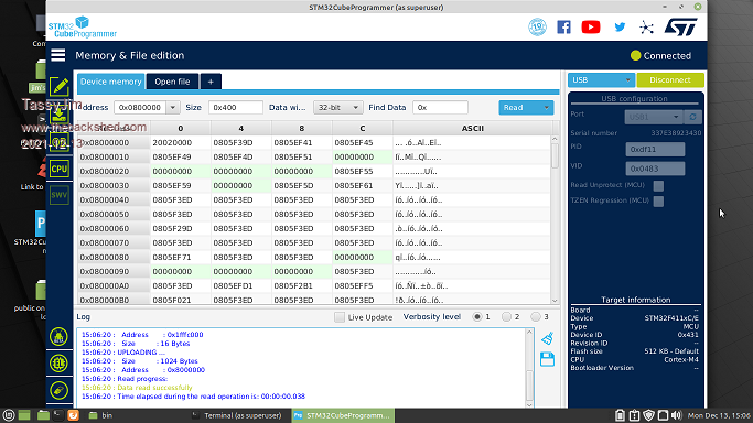

Yes, Linux Mint's System Information tool shows it as in the image above, so Mint knows it's there with the correct matching VID and PID and it even shows it as being in DFU mode, but Cube Programmer flatly refuses to see it at all.  All I ever get from Cube, is "No DFU detected", despite the VID and PID being exactly correct, and Mint seeing the module with those exact settings.  Bit of a head scratcher, this one!

I got curious and loaded cubeprogrammer on my Linux Mint
The blackPill is detected in bootloader mode
[  793.513894] usb 3-1: new full-speed USB device number 3 using ohci-pci
[  793.710767] usb 3-1: New USB device found, idVendor=0483, idProduct=df11, bcdDevice=22.00
[  793.710778] usb 3-1: New USB device strings: Mfr=1, Product=2, SerialNumber=3
[  793.710784] usb 3-1: Product: STM32  BOOTLOADER
[  793.710790] usb 3-1: Manufacturer: STMicroelectronics
[  793.710795] usb 3-1: SerialNumber: 337E38923430
and the system report gives the same info as yours.
My results are the same - no joy.
As far as I can determine, the actual application has the right permissions but with Java, who knows.
Sorry I couldn't help solve the riddle.
Posts: 6624
Posted: 04:16am 13 Dec 2021
I spoke too soon.

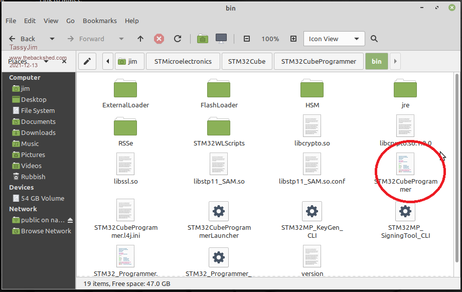

navigate to Graeme/STMicroelectronics/STMcube/STM32CubeProgrammer/bin
right click on STMCubeProgrammer
and "run as administrator"
bingo!!!
And No, you can't just right-click on the desktop icon ans select "run as administrator". That would be too easy.
And the fact that you are in the administrators group probably doesn't make any difference.

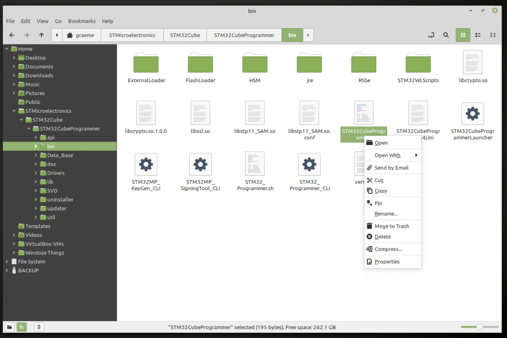

Posts: 10060
Posted: 06:07am 13 Dec 2021
Won't work for me.
Still says no DFU detected if I right-click run that file.
You say run as administrator - but there is no option to do that if I right-click that file.  I can only open it normally.  There simply is no menu entry saying "Run as administrator" when I right-click that file.
Have I missed something?
EDIT: Here is a photo of what I am seeing....
Edited 2021-12-13 16:14 by Grogster

Posts: 3411
Posted: 07:07am 13 Dec 2021
What happens if you select the bottom one, Properties? Can you set the permissions there?
Still on Mint19 so may be different.
Edited 2021-12-13 17:10 by phil99

So in YOUR Mint Jim, you have a "Run as administrator" option in the right-click menu, correct?
Posts: 10060
Posted: 07:09am 13 Dec 2021
  phil99 said  What happens if you select the bottom one, Properties? Can you set the permissions there?
NO.
I did look at that, but there is nothing in there that allows me to tell Mint to run the file as administrator.
Posts: 6624
Posted: 07:11am 13 Dec 2021
  Quote  So in YOUR Mint Jim, you have a "Run as administrator" option in the right-click menu, correct?
Yes
