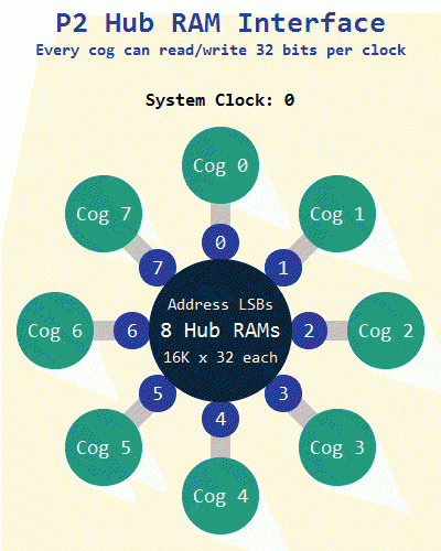

While it's true that the worst case scenario is that a cog has to wait 16 clocks to access the hub (the old P1 only), you wouldn't do this for super time critical operations.
Each cog has a local 2K (496 longs) of memory. The Prop supports mixed memory models:
My_time_critical_routine COG 'This will launch in a cog and never access the hub
                            '@80MHz this executes 20MIPS
  waitpeq state, mask       'execution halted until pin equals (waiting fast)
                            'alternatively waitpne (not equal)
 ' do whatever, after the pin equals the mask
For other non critical code, you specify LMM (large memory) instead of COG to utilise the hub.
If you need faster than 1/20,000,000 sec, you need the P2
