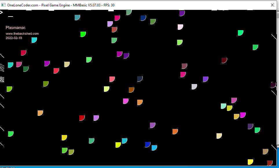

test your "atomsprite demo"
frame problems
if box disabled all looks ok

Posts: 12059
Posted: 09:32am 18 Feb 2022
  Quote  I am sorry for taking time from more relevant development issues.
Please don't give up. Every report is useful and the more info the better. It is highly likely there is a bug in paste as this is new code that is completely different from the CMM2.
  Quote  frame problems
Thanks for the report - found it and will fix in next version
