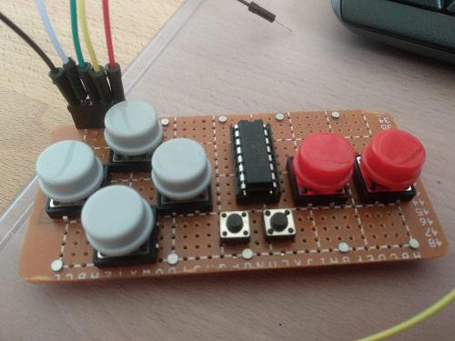

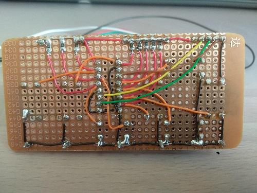

  Mixtel90 said  All controllers will have to work on 3V3 - I haven't got space for level shifting and it makes life difficult. :) In theory the CD4000 series is ok at 3V.
The new old-stock Famicom clone controller that I was playing with previously worked at 3V as did the controller I built on perfboard:
EDIT: The photo of the back of the board is from before @Volhout told me I was pulling down some (unused) pins on the IC that should have been left floating - I've since fixed that, Thanks.
Infact in the case of the former it was only when I tried to run it "in-spec" at 5V that I started seeing the problems that ultimately led to me ordering a new cable (not yet fitted after 2 years) and promising to send @Turbo64 the old one so he could teach it to respect its elders.

Posts: 4410
Posted: 11:44am 21 Mar 2022
  Mixtel90 said  @thwill
Quality construction, I see. :)
Note the SMD pull-up resistors - I'm learning all the hacks.

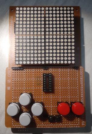

  Quote  Actually, that joystick module and a couple of buttons in a little plastic box would make a rather nice DIY controller.
One day I was going to make that my first PCB, but the harsh mistress of software keeps dragging me back from the loving arms of hardware. Be my guest if you want to run up a PCB, I'm not certain I have a schematic but I can look.
It's actually a component of a larger project, the "Nonetendo Lameboy":
Which was going to use a 28-pin Micromite (back before everything became Pico shaped).
The image is just a mockup, though I did get the display wired up and write the MMBasic code to drive it.

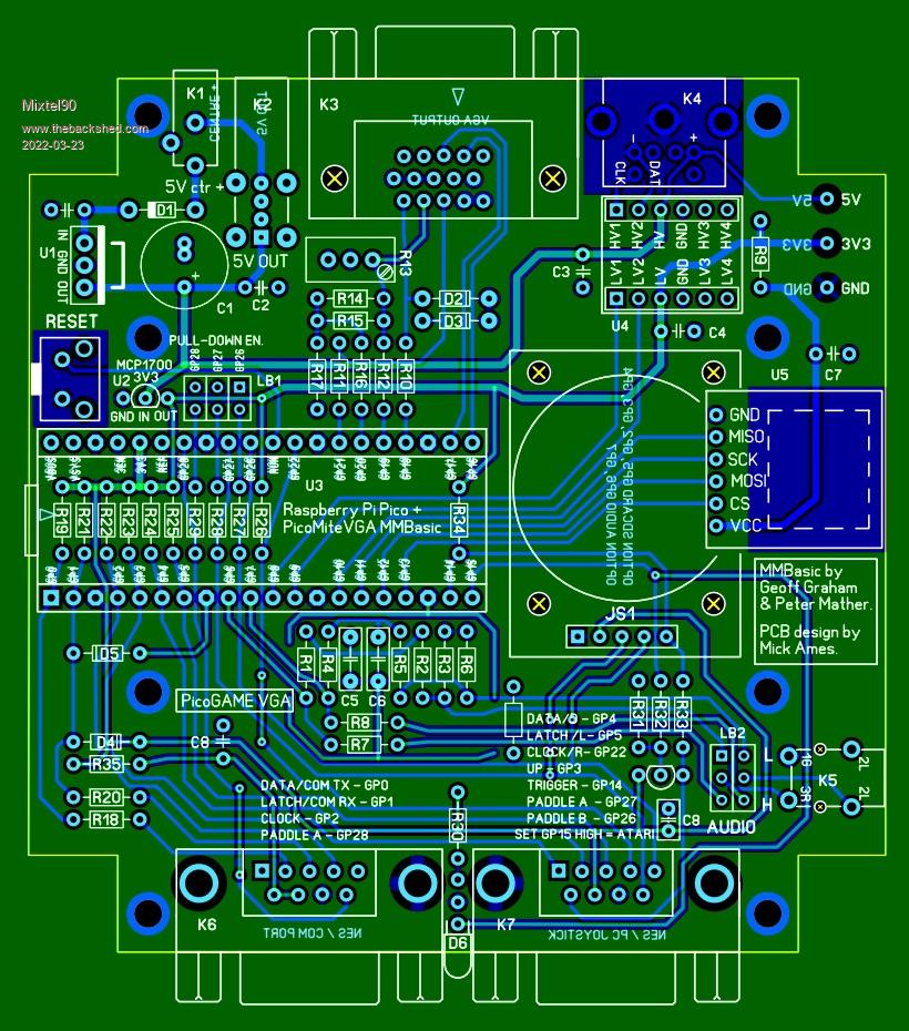

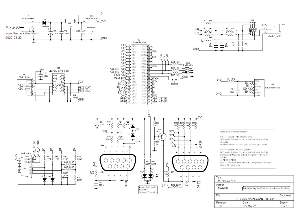

Posts: 9329
Posted: 03:36pm 22 Mar 2022
This is it so far. The joystick module I have has 90 degree connections but this board is designed to have straight connections on the back. Short leads with Duponts could be used. Note that it replaces the RH controller. Component values are in the "should probably work" range. :) I've changed the VGA connector to the one used on the CMM2 as it's easier to get in the UK.
Posts: 6254
Posted: 03:46pm 22 Mar 2022
Nice Mick,
1/ Do you really need a 10 turn potmeter to adjust precisely for R13 ? I haven't build a VGA picomite yet, so maybe you do to achieve the correct white balance in 320x240 mode?
2/ Replace D1 with a shottky diode (SB140 or so), otherwise the 5V from the power supply may only be 4.3V or even lower. Keyboards can be power hungry...
Edited 2022-03-23 01:53 by Volhout
Posts: 4410
Posted: 03:51pm 22 Mar 2022
Hi Mick,
I vaguely thought there was power-out for a VGA to HDMI converter, can I just not see it, or does it not exist ?
Have you checked to see whether any of the components are made of unobtanium ?
Was this an academic exercise or are you planning on building one ? If/when you are confident (and have triple checked) and post some Gerbils [sic] then I'm happy to absorb the expense and order the boards and post a couple of them to you along with a pair of controllers ... when they arrive ... June at the earliest.
Posts: 9329
Posted: 03:55pm 22 Mar 2022
No. In fact, on the one I'm using at present uses the original circuit, with just a 240R resistor in that position (the ladder originally used 120R and 240R values). However, the 10-turn pots are not much different in price to skeleton ones, you don't need to add a series resistor to reduce the range of control (it's only going to be about 150-200R) and they are dustproof. They are just as easy to get from most sources.

Posts: 9329
Posted: 04:20pm 22 Mar 2022
That USB-A is, in fact, the 5V output. :) It's fed from the 5V supply. Normally that's from the input socket with U1 linked out. If U1 is fitted it's a 78xx-compatible switching reg that can handle up to 40V input. It's rated for 800mA continuous or 1A short term current. It should be ok for the total load including a VGA-HDMI converter.
As far as I can tell all the components should be ok to get. I've not done a BOM at the moment though.
I did it as an exercise to see if I could do it, originally. :) However, I think it checks out ok now. I'll go over it again as I made a couple of minor changes - you can end up with daft things like isolate ground connections sometimes! I think it would be a fun little project. It's still a PicoMite VGA with SDcard and audio, just some specialised IO stuck on it.
