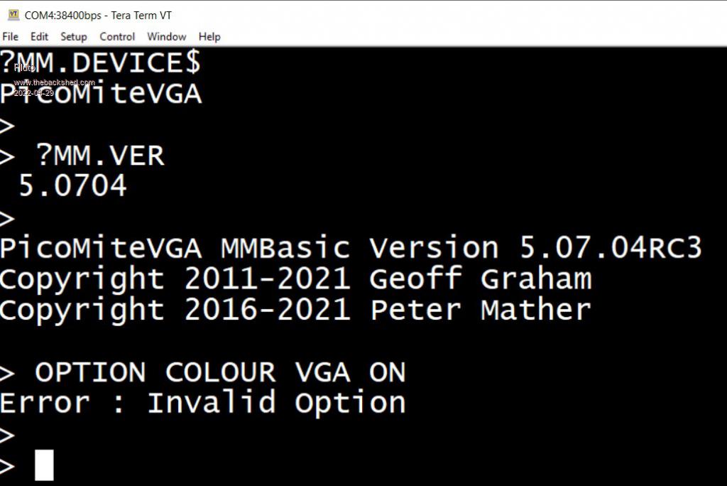

Posted: 10:33am 29 Apr 2022
I have tried to colors on the VGA, but w/o success.
Tried with 2 different Picos with the same result.
/Fred
Posts: 11993
Posted: 11:00am 29 Apr 2022
See the first post on the thread
Pluto
Joined: 09/06/2017
Location: Finland
Posts: 412
Posted: 11:30am 29 Apr 2022
OPTION COLOUR VGA ON|OFF replaced by OPTION DEFAULT MODE 2|1 solved my problems.
Thanks Peter!
