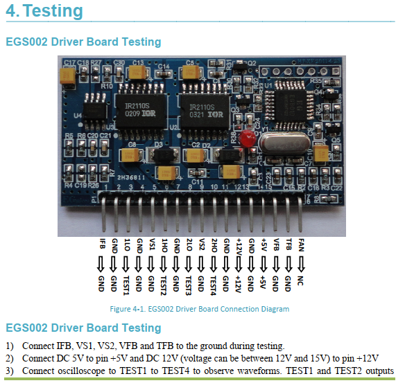

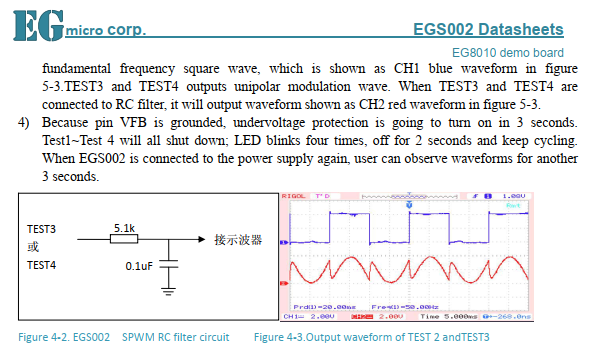

The low side and high side Gate drive for the 50Hz squarewave (fundamental)
are pins 3 and 6 respectively.
from the EG002 pdf:
