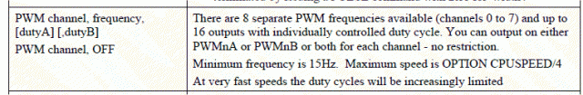

What have I got wrong here?
> ?mm.ver
5.070506
> SetPin 1,pwm0A
> pwm 0,1000,100
> pwm 0,1000,0
> pwm 0,off
Error : Syntax
(Note: the LED turns on and off as expected. PWM 0,OFF also doesn't work if the LED is still on.)

I've put an over enthusiastic syntax check in somehow. Will fix. In the meantime use
pwm 0,off,0
Posts: 3885
Posted: 07:22pm 11 Jun 2022
Ok, thanks.

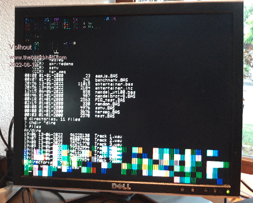

Peter,
There is a serious problem with PLAY WAV "filename.wav".
It looks like the audio buffers overlap with the tile memory (colors) in mode 1.
Using 5.07.05b6
The audio sounds okay though. Even if I do a CLS in mode 1.
When I used the switchmode powersupply there was all kinds of noise and even the SD card trafic was audible. Now with the linear regulator all is noice.
The only thing that is audible is a little noise in the silent passages, but it is constant noise, and can very well come from the 11 bit resolution.
Needed to connect my living room audio system to be able to distinguish this noise. On (my) headset it is not audible at all.
Edited 2022-06-14 05:43 by Volhout
Posts: 6171
Posted: 06:17am 14 Jun 2022
Top part of the screen seems corrupted by audio data. Bottom part of screen is corrupted by meta data. That only changes when you play a different track.
