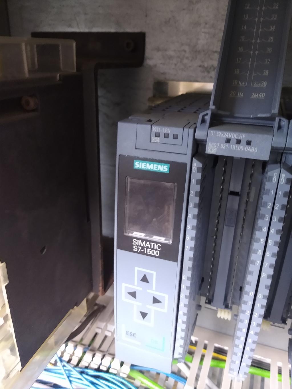

So, this CPU module goes for 2800 quid(!!!!) and doesn't do a darned thing....until you add the 500 quid interface modules.
The proposed MultiMite PLC would smoke this rubbish
Craig

Mick You sir would be a god worthy of Song and praise if you could develop some kind of pico mite PLC that doesn't suck as much as Allen Bradley Connected Components Workbench or Simatic, I never could figure out Simatic
