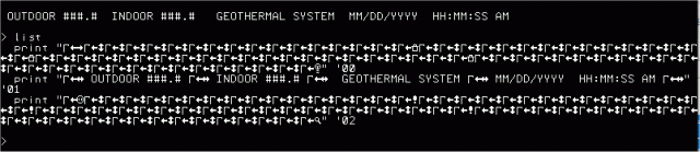

Suppose I want to print this with MMBasic for Windows:
? OUTDOOR ###.# ? INDOOR ###.# ?  GEOTHERMAL SYSTEM ? MM/DD/YYYY  HH:MM:SS AM ?
I load the program:
print "???????????????????????????????????????????????????????????????????????????????"
print "? OUTDOOR ###.# ? INDOOR ###.# ?  GEOTHERMAL SYSTEM ? MM/DD/YYYY  HH:MM:SS AM ?"
RUN, then LIST gives me this, with the characters over 127 stripped out:

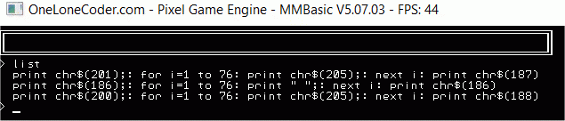

I can get the box characters with this:  print chr$(201);: for i=1 to 76: print chr$(205);: next i: print chr$(187)
 print chr$(186);: for i=1 to 76: print " ";: next i: print chr$(186)
 print chr$(200);: for i=1 to 76: print chr$(205);: next i: print chr$(188)
Is there some code page or other magic I can use to make the straight print of the PC graphics characters within a quoted string work?

  Quote  Is there some code page or other magic I can use to make the straight print of the PC graphics characters within a quoted string work?
No: Characters over 128 are tokens so can't appear in a program

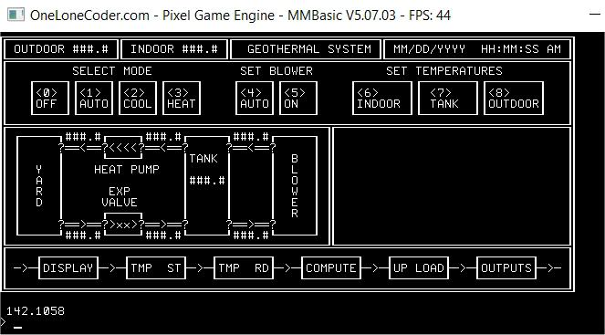

Not sure what you mean. The CHR$() method works. Plus, by using DEFINEFONT to replace the first 13 lower case letters with the PC graphics pixel maps, I've gotten this to work on H7, F4, PicoMite, and MMB4W (Hmm, if I define them below CHR$(32), that would probably be more convenient).
  Quote  The graphics screen on MMB4W supports the enhanced graphics commands, I believe, with text boxes, colour etc. I think I'd use that personally.
I've got that working. Paul_L, however (at least for now), would prefer to use the PC box drawing characters if it's not too inconvenient.

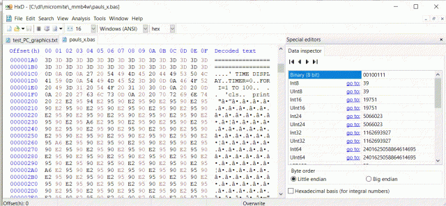

But I have a question for you (or anyone else). The files which Paul has sent me which show up as proper PC graphics drawing characters have those characters actually encoded as UTF-8 triplets, where the first 2 characters are 0xE295 and the third designates which E295 character is encoded. (Looking with the hex viewer HxD.)
How do I save this file so that the 3 characters are converted to the appropriate 1-character above-127 value?

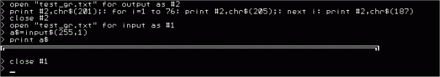

So, a file written by MMB4W with the graphics characters in it can be read back and printed and they print correctly:
So my question is, how can I write a UTF-8 encoded file so that it's just plain 8 bits per character?

I'm confused because I don't think 0xhE29590 is a valid UTF-8 sequence, for a start 0xE2 <= 0x7F so would be interpreted as plain ASCII and can't introduce a UTF-8 sequence ... I'm no expert though and may be talking bo**ocks.
Edited 2022-06-22 00:59 by thwill
Posts: 3885
Posted: 03:05pm 21 Jun 2022
  thwill said  I'm confused because I don't think 0xhE29590 is a valid UTF-8 sequence, for a start 0xE2 <= 0x7F so would be interpreted as plain ASCII and can't introduce a UTF-8 sequence
Uhh, I think 0xE? is greater than 0x7?. But I'm confused too.
Edited 2022-06-22 01:06 by lizby
Posts: 4405
Posted: 03:10pm 21 Jun 2022
Oh, sorry, yes ... you are correct and I'm tired, 0xE2 can start a UTF-8 sequence.

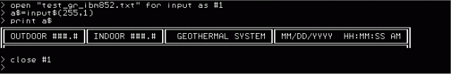

Now we're getting somewhere--thank you very much, Tom. That conversion site did the trick--convert UTF-8 to ibm852.
So UTF-8 text (if the forum doesn't do something to it)
converts to ibm852
ษอออออออออออออออหออออออออออออออหออออออออออออออออออออหอออออออออออออออออออออออออป
บ OUTDOOR ###.# บ INDOOR ###.# บ  GEOTHERMAL SYSTEM บ MM/DD/YYYY  HH:MM:SS AM บ
ฬอออออออออออออออสออออออออออออออสออออออออออออออออออออสอออออออออออออออออออออออออน
And if I read it in to MMB4W with "a$=INPUT$(255,#1): PRINT a$", I get this:
Again, thanks very much, Tom. I think this puts me on a path to further investigation.
