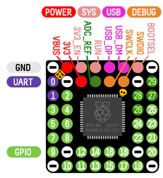

I'd be surprised if you could find one that approached being equal to the Pico for connecting. The Pico hardware is nice because they haven't given in to the urge to crush everything into the smallest possible space. The board has more ability to get rid of heat from the components and also distributes ground points well to separate some of the very high speed signal edges that you can get from this beastie. If you mean quality of assembly, then I doubt if there's any difference now.
I would only consider the compact versions if I was simply too short of space for a one-off project. It's important for something like a drone, but pointless for just about anything else. For a quantity project I would seriously consider getting the RP2040, clock and flash mounted directly onto my own PCB. It cuts out a whole layer of unwanted connections.
I've tried laying out a compact pcb using the RP2040 Stamp on 2-sided board - I'm not going to bother. It's a pain in the backside, even though everything apart from the USB connector is on-board. Things would be better on 4-layer board, probably, but I've not attempted that stuff yet.
You don't necessarily save any space by using a compact module. You still have to get a lot of tracks away from it, but now from all sides. You get a sea of vias. Even surface mounting a normal Pico makes life a lot more difficult as you can't get tracks away between the pins unless you make them really thin or reduce the pad size down from what's recommended.

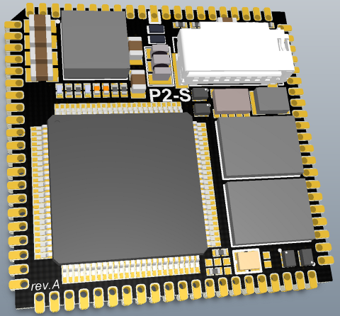

I'm a know-nothing regarding this stuff but I follow the developments of the various P2 modules and there is one that is similar to the RPi Pico (albeit with double-row connectors running down each side). Here, they stipulate not to exceed 180MHz whereas, with the more-compact (shorter traces) "Edge" module, they are running quite happily @370MHz.
Can't wait to see the new design from Knivd because this is the most compact of all.
Personally, I find the PGA2040 an absolute breeze to work with; more pins and no flimsy micro-USB to worry about.

Knivd's P2 module [drool]

I like to be able to lay things out on a PCB, not fight it. I'd rather add 3 sq in of board than consider one of those. I can't even mount resistors underneath it, never mind a 4-channel level shifter. :)  My time is far more expensive than PCB area so there's no point in crushing things up.
