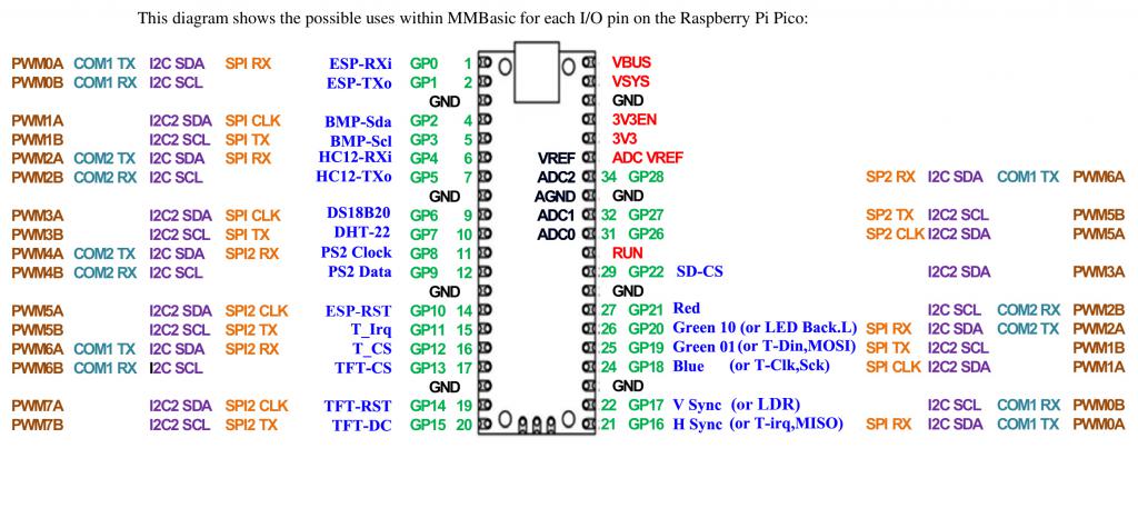

"The pictures you have posted show the MISO for the LCD snipped off"
If that is how the supplier sent it then it suggests they may have the same issue as the ILI9488. As a precaution for testing solder a 680? to the top side of that pin and bend the other leg around to go in the socket. A more permanent fix is to cut the track going to that pin and solder a very small SMD resistor across the gap, though replacing the cut pin will be a bit tricky.
From the manual page 36 near the bottom.
"ILI9488/86 (connect MISO with a 680? series resistor as the controller does not tri-state its output properly)"
Edited 2022-06-28 10:32 by phil99

MISO (master input, Slave Output) goes to both the touch pins and the tft pins, removing the pin as I did only removed MISO from the TFT pins, the touch still has MISO else it couldn’t communicate touch data back to the CPU, for the test I did I rejoined the MISO line to the tft (wire from the tft to the pcb it is fitted to)

I changed the configuration for my setup as follows:
'MICKS CONFIGURATION
LCD_DC=MM.INFO(PINNO GP15)
LCD_RST=MM.INFO(PINNO GP14)
LCD_CS=MM.INFO(PINNO GP13)
SD_CS=MM.INFO(PINNO GP22)
T_CS=MM.INFO(PINNO GP12)
T_IRQ=MM.INFO(PINNO GP11)
MYSPI=1   '2 id using spi2 pins
SPITX=MM.INFO(PINNO GP19)
SPIRX=MM.INFO(PINNO GP16)
SPICLK=MM.INFO(PINNO GP18)
I have checked and triple checked I think I set all of the PINNO correctly. This is the list of the Pin Allocation on my PCB. Note My allocations are in Dark Blue
