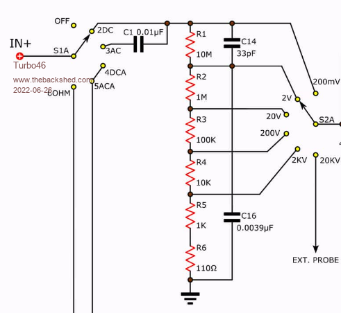

Turbo46
Joined: 24/12/2017
Posts: 1694
Posted: 10:29pm 25 Jun 2022
Here is a partial circuit for a DMM input. Notice the 'compensation' capacitors used to flatten the frequency response for the AC ranges. They would be causing the triggering of the 555.
Test instruments can affect the circuit that you are testing.

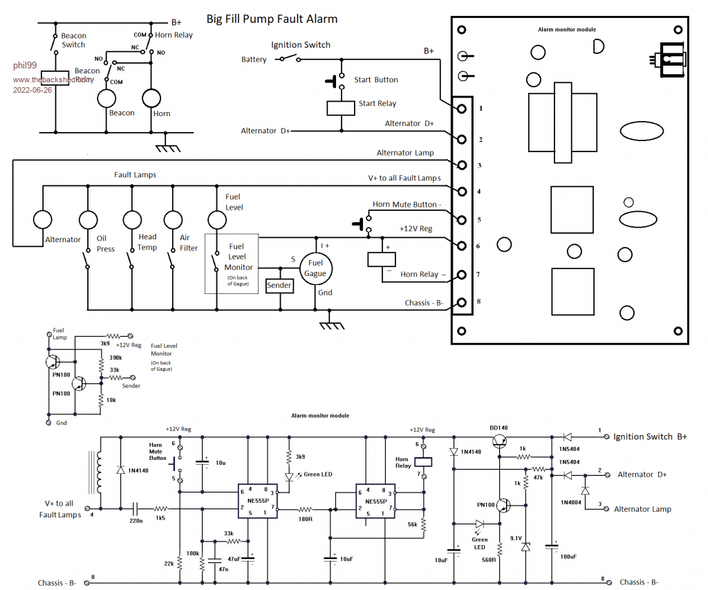

Posts: 3348
Posted: 04:06am 26 Jun 2022
Much of the above is about the problem of triggering on transients. Below is an example of where you want it to trigger on transients. The local fire brigade was building up a large trailer mounted diesel pump and wanted something more than just the usual engine warning lights. The idea I came up with was to put an inductor in series with the supply to the engine fault lamps. When ever there is a sudden increase in current the transient produced by the inductor triggers and latches a 555. A mute button resets it, ready for the next fault. Another 555 pulses a horn and the Water Point beacon (no matter whether the beacon is switched on or off).

Turbo46,
I looked at a couple of DMMs and see a comp cap near the input. Looked at both of the analog meters I used and they don't have a comp cap on the DC inputs (not needed).
Perhaps the take away from this is that having the same path to the measurement circuitry for DC and AC in a meter, like a DMM, affects the DC path. Money saved for the DMM manufacturer but adds a bit of puzzling behavior for the DMM user.
