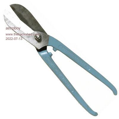

Hi
Someone told me that we can do a good job with tin snips like this which I guess is like a small guillotine.  I haven't tried it yet.  I wonder if anyone here has.
Posts: 9329
Posted: 07:18am 13 Jul 2022
Snips have a shearing action, but they bend one side up and the other down during cutting. You can get some that keep the material flat on one side or the other and bend just the waste side. If you have some, test them on a bit of scrap pcb.
I wouldn't recommend snips for this job as the panel pieces are a bit fragile and the thin bits may snap.

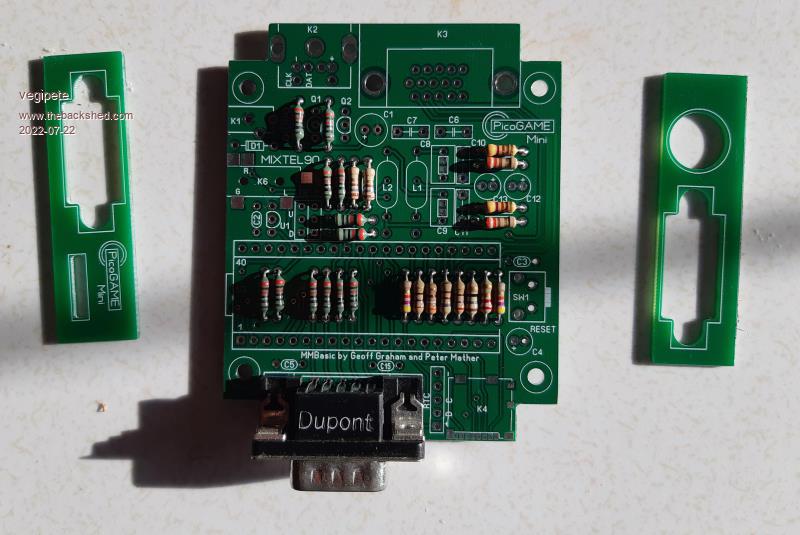

Yesterday the postman pushed an envelope through the slot - containing a PicoGAME Mini PCB! Thank you Lizby, that's awesome!.
I lopped off the ends and started soldering:
I didn't have a suitable VGA connector in my junk, too bad, so sad.
At work today, I harvested a VGA connector from an old motherboard in the e-waste bin. The motherboard didn't like the propane torch much - thank goodness for the fume extractor in the welding room.

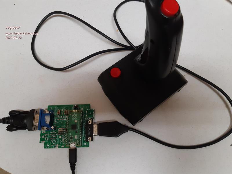

A bit more soldering and fiddling with single row female headers and this is the result:
Power is via USB at the moment, no sound yet, but it works splendidly. Mixtel90's test programs from the PicoGAME VGA development thread work fine within the limits of the Mini. The joystick I plugged in is supposed to be an Atari equivalent. The fire button seems to be on GP14 so I might change R10 to a bigger value - 150 ohm is kinda low for a pull-up. I must find my genuine ancient Atari joystick and test it.

The 150R value is because pin 14 is also the power supply pin for a NES-type controller. You can increase the value if you want to, but if you then want to use a controller you'll have to remember to set GP14 to DO and high to power it while you do, then make it DI again for a joystick.
It's looking really good so far! :)  Did you get one of the little boxes for it? I'll be interested to see if the connectors, end plates and box all work well together. :)

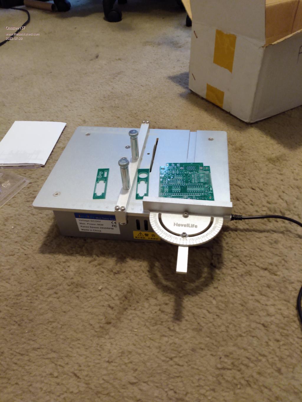

Quazee137
Joined: 07/08/2016
Posts: 603
Posted: 04:32am 29 Jul 2022
Thanks lizby
  Got the board and now looking through older parts as all my newer are SMD.
  I used my PCB saw from my last big project of 500 panels of 3.
  Nice when a project pays for new FUN toys.
Posts: 9329
Posted: 06:42am 29 Jul 2022
Lovely little saw! :)
