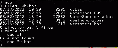

  PeterB said  When I LOAD XXXXX$ or variations of it
I get "can't open file".
Loading from a variable apparently doesn't work (I don't know why that needs to be the case). But loading a quoted string does.

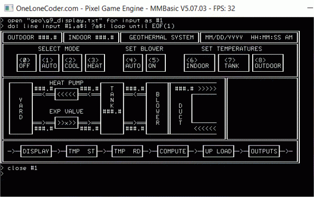

  PeterB said   "G9.BAS" . . .
When I try to RUN I get a message that g9_display.txt will not run.
I didn't remember having posted g9.bas. What's the date on that?
Anyway, here's the latest version of g9_display.txt (zipped because of above CHR$(127) codes, which might not display properly). Coding is Code Page CP-437. MMBasic for Windows will properly print IBM graphics characters in CP-437 coding.
g9_display.zip
G9.bas will need to be changed to point to wherever you put g9_display.txt.
Once unzipped into your directory, this will print the file:
OPEN "g9_display.txt" for input as #1
do: line input #1,a$: ?a$: loop until EOF(#1)
CLOSE #1
(Note: this exact code also works in MMBasicDOS.)

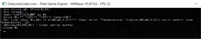

  PeterB said  I can now flip Pico pins using TeraTerm or MMBASIC. I have yet to read a pin
Congratulations. That's a good part of the battle. Here's how to read a DS18B20 temperature sensor attached to the PicoMite talking to MMBasic for Windows over serial.
(Note--in order to get long lines to work, I set MODE 9 and FONT 1. Any error message changes the font, so if you are fiddling and get errors, you may need to repeatedly set FONT 1.)
The code is:
dim string a$,QT=34 ' scratch variable a$ and double-quote
dim integer i
open "com7:115200" as #1 ' change to suit your COM port
print #1, "? "+QT+"! "+QT+"; tempr(10)" ' this says print "!" and temp from pin 10
do: line input #1,a$: if mid$(a$,1,1)="!" then: print "Temperature: ";val(mid$(a$,4,2)): exit: endif: loop
a$=input$(255,#1) ' clear the serial buffer
close #1
"Temperature: 23" gets printed.
Note that I put the "DO" loop all on one line so that it could be typed at the ">" prompt. In a program, you would unroll the DO for legibility and so you could add comments. Reading a pin would be similar. After setting it up with SETPIN, you would do "print #1, "? "+QT+"! "+QT+"; pin(1)" (for instance).
I put the PRINT "!" in to make it easier to pick out the line containing the returned temperature reading.
I just noticed that you can use VAL(MID$(a$,2)) instead of VAL(MID$(a$,4,2)) and it will ignore leading spaces and give you any decimal places, e.g., 23.75.
