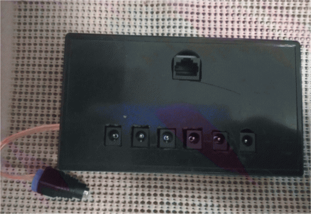

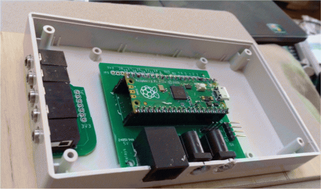

This is a very timely thread for me. I've found these Aliex boxes in black and white which are a good size for me: https://www.aliexpress.com/item/1005001849742165.html -- 140x82x38mm.
But it takes me an inordinate amount of time to do a not very good job of making the cutouts.
On that latter box I still have to drill 5 holes for another mini-stereo-jack x5 PCB.
So if I can design my own boxes for JLCPCB to print, I'm bound to come out ahead if I value my time at all.
Thanks especially, IanT, for posting that enclosure code. It should get me started.

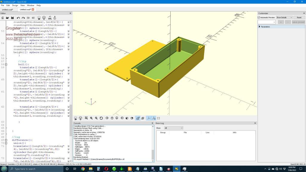

Thanks very much Ian, for your code examples.  They import and work just fine.  The 2nd code you posted for the box, produced a very recognizable result in the form of a small project case with a matching lid:
This gives me a basic project box and code, that I can play about with, just to learn how to do things, which I think will be helpful for me to learn the program a bit better.
@ lizby - yes, it is the damn hole-cutting and various machining aspects that I hate about building any project.  I might even just use the example that IanT posted above, and use that to get JLCPCB to make me a couple of those little cases, so I can examine the finished result and see if it is a process I would like to use moving forward.
I'd still welcome anyone else's openSCAD code/programs, to give me more things to play with.  Does not even have to be a project case, just anything at all that I can play about with, and see what changing various bits of code does to the result etc, to help me learn it.

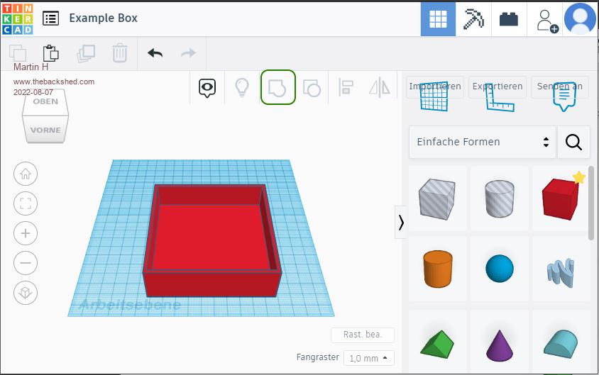

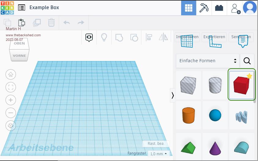

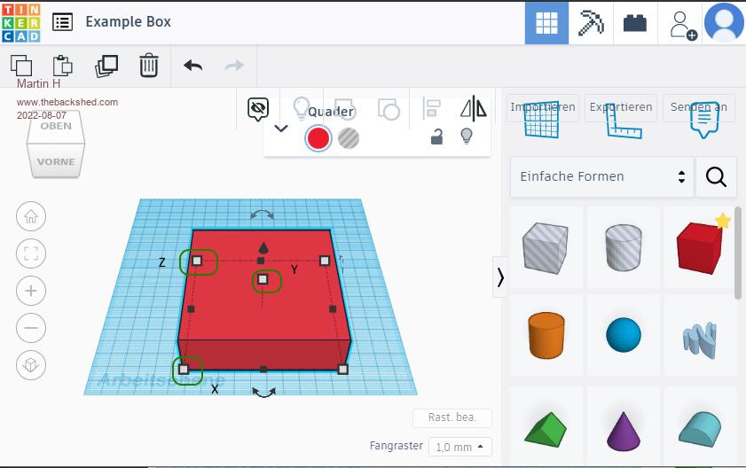

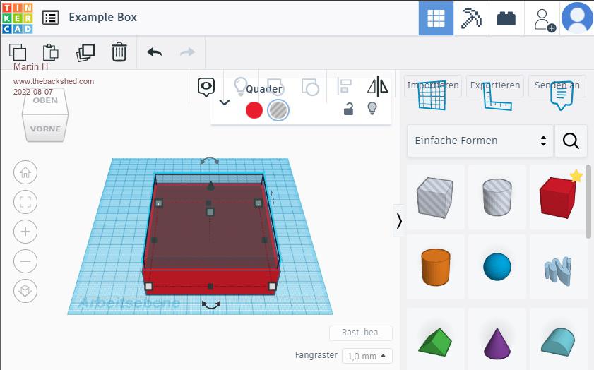

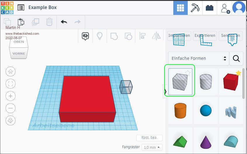

Posted: 10:25am 07 Aug 2022
simple Example Box in Tinkercad
Use the Box Shape
Place and resize it as you whish
select the shape to cut
Resize it and place it inside the Box
merge both Shapes to one
there is the Box.
Which can be downloaded as .obj, .stl, .gbl or .svg File
imho. for simple Shapes an easy way to construct.
