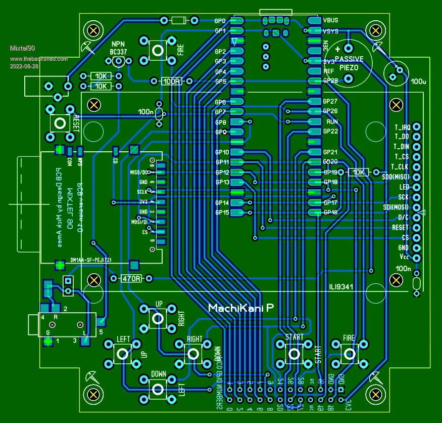

Hokay... If anyone wants to have a play on a custom PCB, here it is.
I've kept very closely to the original circuit apart from the audio side. I can't find any BOM and, since he appears to get different frequencies, I've assumed that it's a passive piezo sounder. Some of these seem to be magnetic rather than piezo and the Pico can't handle the current so I've introduced a transistor to handle the sounder current. I've also put a solder blob link as I assume most people will be using a stereo jack and will want the sound on both channels rather than just Left. If you are using a mono jack you'll have to cut the link.
All the original I/O is available, but I've kept the Pico GPIO numbers as we, on this forum anyway, will find them more sensible.
I've only got the same info on this as anyone else, so it's doubtful if I'll be able to help with any support that isn't a PCB mistake. :)

Mick , thank you for the design. All great work. Gonna order a couple or three , see where the price break is. Not sure it's something I will use a lot , but I like your board so will make one (or 2).    Jack.
Posts: 9183
Posted: 03:23pm 28 Aug 2022
If you order from JLCPCB yu can get five boards for not much (Lizby said about $6.38 but I'm not in the US). Very easy to order from them too. They fit into the "special offer" size of 100mm x 100mm.

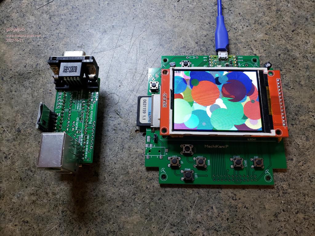

Posted: 12:59am 29 Aug 2022
Thanks Mick. I ordered 5 of this board and 5 of your picomite vga stick board. Can't beat the cost , even with shipping the whole order was about 10 bucks. got a first time order discount. Jack.

Posted: 08:59pm 20 Sep 2022
To Mick , I got one of each board built and tested. Working great! Thank you for the great designs.
Jack
Posts: 9183
Posted: 07:51am 21 Sep 2022
I love it when people get my designs to work. :)  Thanks for showing us.

Posted: 04:17am 22 Sep 2022
Mick , yes I have ran all the samples that came with the basic package and converted the colored circle program from the basic here. It does ok , but not quite in the same league as pico-vga or cmm2. Still a neat toy on a very nice pc board.

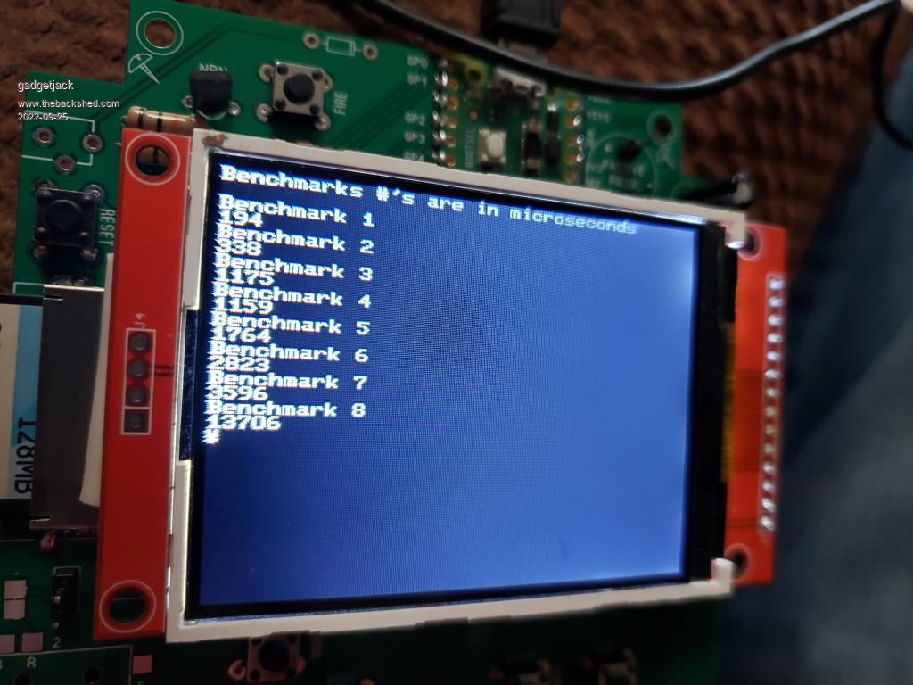

Do you think it's a compiler? Personally, I'm not sure if it's just tokenizing the ASCII source file. It would be interesting to try running some of the MMBasic benchmarks on it (with modification, obviously).
Your mission, should you choose to accept it, is to make this PCB into a MMBasic gaming platform.
(With apologies to "Mission Impossible!")

Posted: 02:05am 24 Sep 2022
Mick , I tried my best to convert the benchmark tests to this little "compiler". Darned if I can figure out even the basic timer function. The user manual is very vague. None of the example programs use the timer so they are no help. Programming anything past a very basic block game is gonna be hard , so probably not a good game platform. I think I will stick to the cmm2 for any games. Still got a nice looking board for this "possible compiler". I tend to agree with you , more like a tokenizer from what i can see. Not as fast as I first thought.

Posted: 07:28am 24 Sep 2022
For the Type P system CORETIMER seems to be a 1MHz interrupt by default. You can't change it as it's synchronized to the clock.
A=CORETIMER() should return the current value of CORETIMER in A. It's a 32-bit integer. A is 32-bit signed integer by default.
So, try:
A=CORETIMER()
do the benchmark stuff
print CORETIMER()-A
the result should be in microseconds, so you should divide it by 1000 to get ms.
Be careful with the variables:
A-Z are 26 32-bit signed integers by default.
use # suffix (e.g. A#) for floating point.
use $ suffix for string, of course.
Unless a variable is specified in a statement you can't have longer variable names.
Of course, you always have the option to use a PCB elsewhere:
These settings should work for a standard PicoMite. Touch isn't supported as the pins aren't connected. Something could probably be done, but it's of limited use with all those buttons.

Posted: 08:09pm 24 Sep 2022
Mick , thanks for the help with the timer. That was driving me nuts. I finally got the 8 benchmark tests to run. Have to say , kind of impressed. The picture shows the screen after run , and it is in microseconds. I like the idea of using  the extra boards for picomites ( even though i have 3 with lcd and 2 with vga output, so far).If you want the basic test I ran I can send it , was a bit long for this post with the picture in it.
