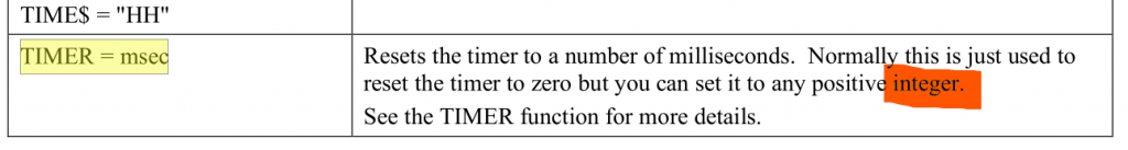

Posts: 1646
Posted: 03:19pm 08 Dec 2022
No-longer limited to integers.

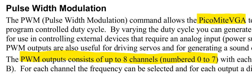

Joined: 30/03/2016
Posts: 1646
Posted: 07:36pm 19 Dec 2022
Craig
Posts: 12237
Posted: 08:54am 20 Dec 2022
Don't understand the second highlight
Tinine
Joined: 30/03/2016
Posts: 1646
Posted: 09:07am 20 Dec 2022
  matherp said  Don't understand the second highlight
My bad....should've read further. It struck me as only 8 PWM pins
