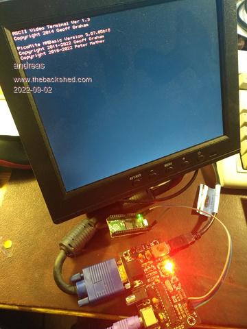

  Mixtel90 said  Interesting - that's Geoff's design as a kit. :)
yes the vt100 terminal shows it in the startup message. below the terminal message follows the latest PicoMite message version 5.07.05b18
The Pico gets its power through the serial connection and the terminal gets its power from the USB cable running to my PC.
To get the serial connection working one has to issue OPTION SERIAL CONSOLE GP0 GP1 when GP0 and GP1 are used to connect to the terminal. I have connected terminal GND to pin 3 of the pico and terminal 3.3v to VSYS (pin 39) of the pico.

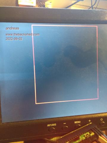

I wrote a tiny vt100 program to draw boxes using ESC sequences and it works
Clearscreen
For x1 = 1 To 400
    drawbox x1,10,400,400
Next x1
End
Sub drawbox(x1,y1,x2,y2)
 Print Chr$(27)+"[Z2;"+Str$(x1)+";"+Str$(y1)+";"+Str$(x2)+";"+Str$(y2)+"Z"
 Pause 30
 Clearscreen
End Sub
Sub Clearscreen
 Print Chr$(27)+"[2J"+Chr$(27)+"[H"
End Sub
-andreas
